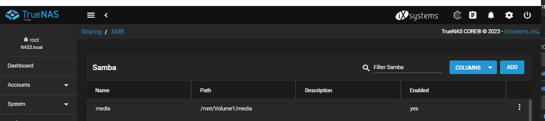

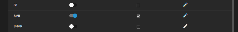

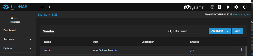

A few things to check for starters:
Is the share listed and showing as enabled at Sharing>SMB?
Is the SMB Service shown as running on the Services page?

Good! Did you use a accountname and PW other than "root" at the Windows request for username and pw?
It doesn't get that far.
ERR_FILE_NOT_FOUND
(when I try and access it via Windows Explorer...)
Note: I'm using the same IP as when I access CORE's control panel, except I put in a "\\" before it.

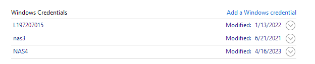

How do I log out though, by the way (without having to "reset" things by restarting my Windows session itself)? Seems like it saves my credentials even if I close the window, which is not desirable in my mind (I want it to ask me every time; inconvenience for the sake of slightly better security I would imagine).
Glad you are in now. There seem to be a plethora of reasons why the ip won't give access when the menu will, and I don't see identifying it over the forum. Suggest that you Google for solutions and investigate the several scenario presented. Superuser and microsoft site each had postings on the topic.
To disconnnect, I would delete the particular credential in Windows Credential Manager.

Also, I see nothing in Windows Credential Manager pertaining to TrueNAS; what I've been doing instead is I just log out of Windows and back in to have it ask me again, but it's less than ideal.
You have nothing for computers on your network under the Windows Credentials tab?
