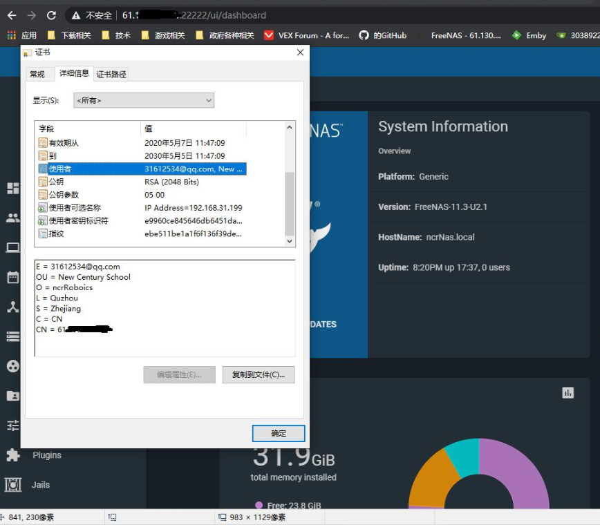

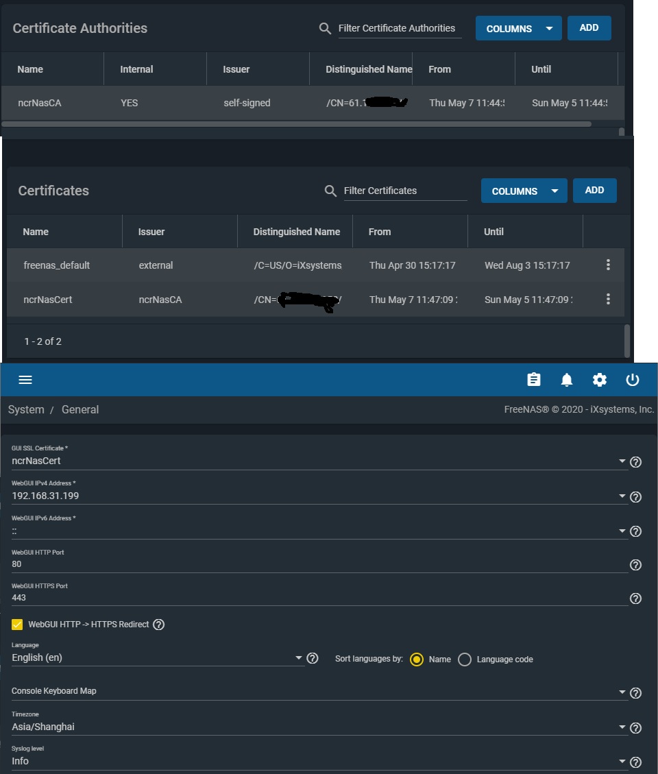

I set up the Certificate Authorities & certificates.

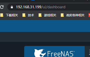

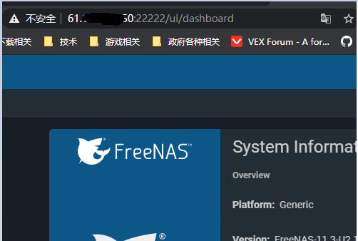

I imported the certificate.Intranet access is normal.But using public IP access is not safe.
Is it unsafe to use public IP access?
I just do a simple port forwarding on the route.

But not because of the cert, to clarify. It’s unsafe to expose the UI to the Internet at large because a) it uses root / password for login, though 2FA in TrueNAS Core will help with that and b) isn’t typically deployed like that, and so not designed for being exposed.

Though it's worth pointing out that the actual issue is almost certainly that the public IP address isn't listed on the cert, but the private IP address is. That would explain a certificate error when accessing externally, but not internally. That's easy enough to fix by making a new cert, but it doesn't solve the problem of exposing a system that isn't designed to be on the public internet to the public internet.

The certificate address is the same as the actual public address. As a result, the intranet access is correct.
CN =61.XXXXX
Do you want to write the port number?
