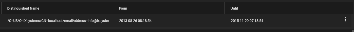

Been having some strange problems with my TrueNAS. In the alerts, i get the "Certificate 'freenas_default' has expired." error. When i check the certificates, i see that the current certificate is from 2013 and lasts to 2015. I have no clue to why the certificate is a couple of years old. Is there any easy way of renewing it or replace it?

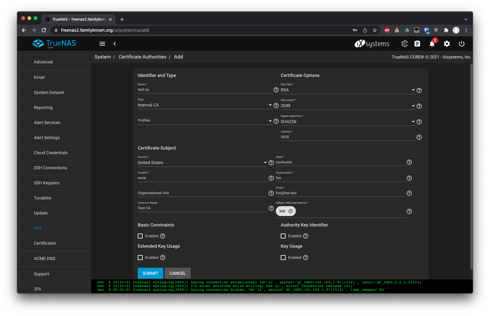

First go to System -> CAs -> Add, type defaults to Internal CA, fill out remaining fields as desired:

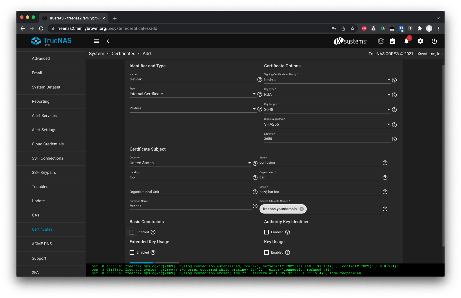

Then go to System -> Certificates -> Add, set the Type to Internal Certificate. Set the Signing Certificate Authority to the one you just created. Fill out the other fields as desired:
You can now select that new cert for whatever you had been using the default cert for, then delete the default cert.
