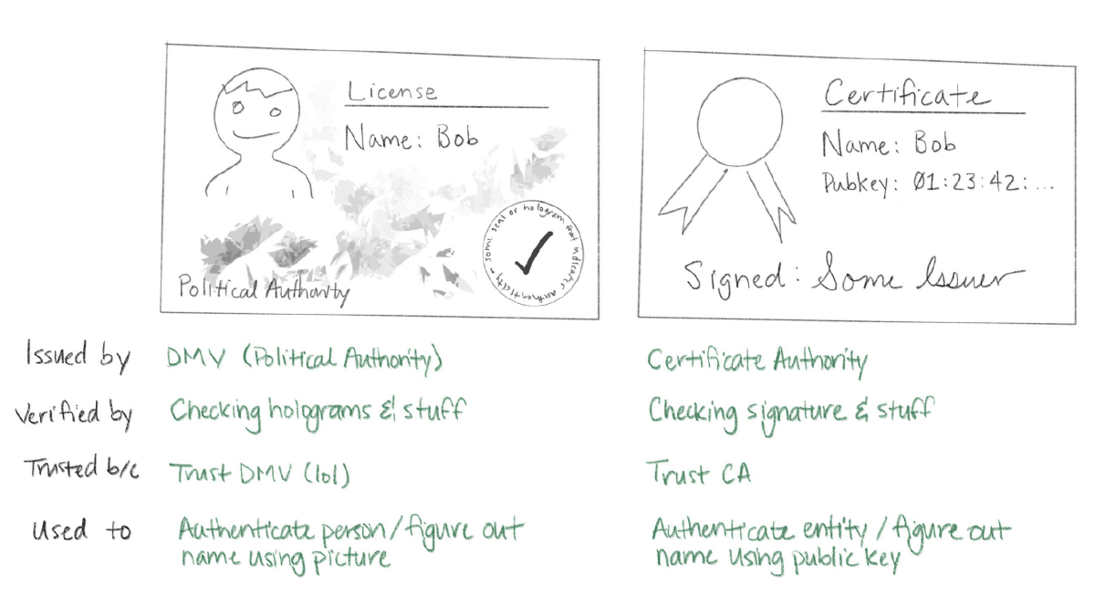

I don't know anything about your setup, and how you are using certificates, or even *IF* you are using certificates in your setup, so I cannot advise your direction.
However, I can highly recommend reading this article:
It will cover what certificates are, why you do (or do not) need them, and where you may or may not use them. Its very good knowledge to have to hand in the IT world.
