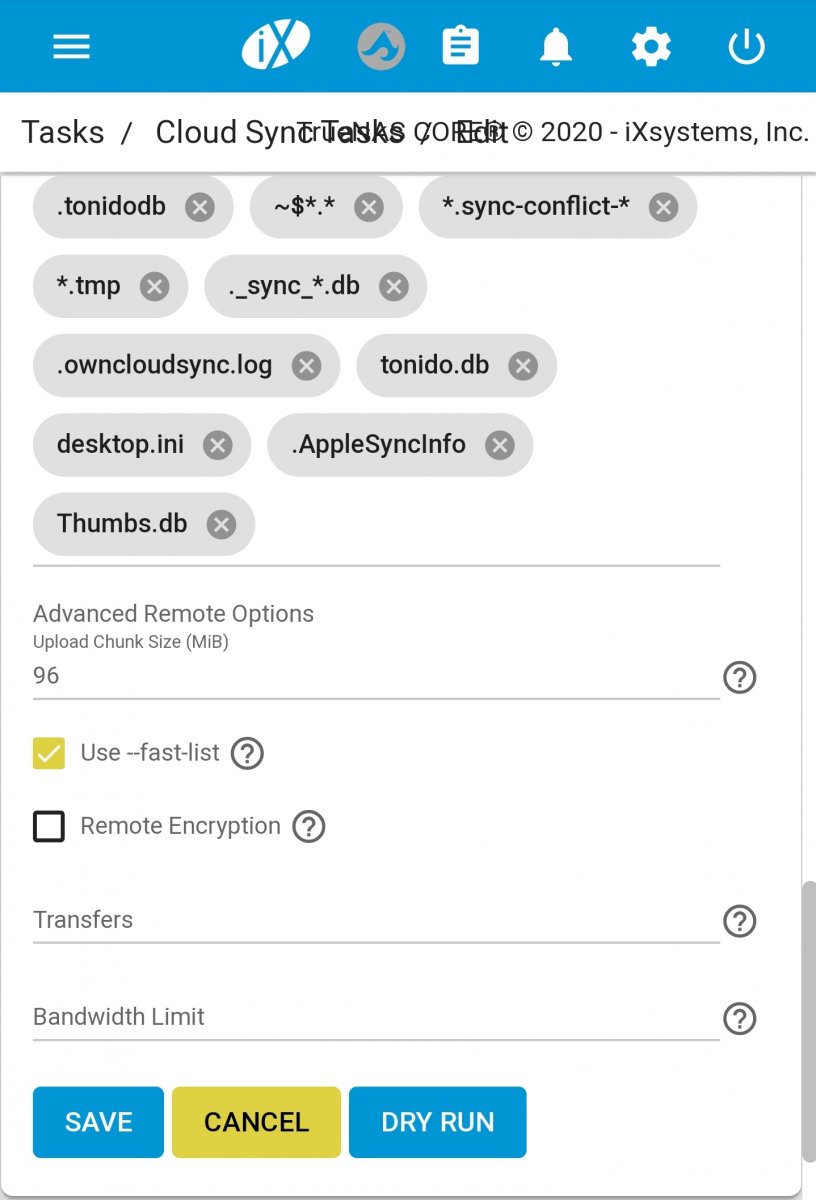

use-fast-list option in the sync task?
I'm really sorry but I'm new to FreeNAS and servers in general. Could you elaborate on this? Is this something I should add to the task in the arguments or something?

I am on truenas core 12.0-u1 and this is one of the options you can tick in the sync task

this is what I have.

What extension is hiding options? I'm using U5 and my theme is the dark theme shown in the manual.
Edit: well how embarrassing my live system is still on FreeNAS-11.3-U3.2

The webapp is already in dark mode, so I think that was the issue to be honest. I just disabled the extension on that webapp and it works fine now
