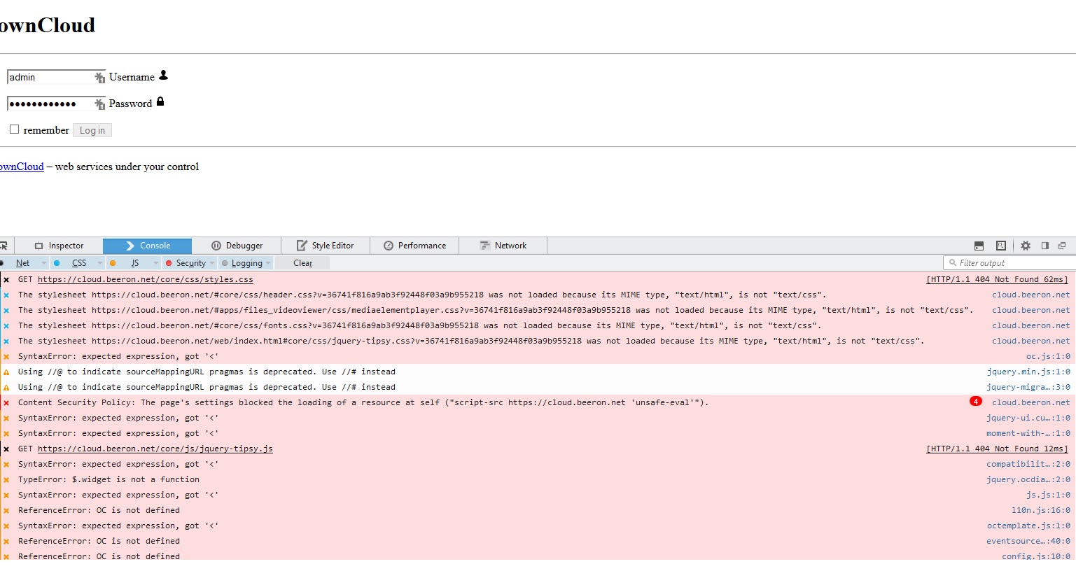

Hi, I've been reading/following this thread as I have been working through this setup. I was able to get owncloud running serving http/https no problem. I also have pfsense and initially configured squid3 as a reverse proxy which worked fine for all other apps https or http I have on my freenas box...but not Owncloud. Is there some special code that must be in the nginx.conf file to allow reverse proxy to work? Or does this lie in the config.php like so many articles on the web discuss? As seen in the attached pict, it appears there are some major problems servicing files through the reverse proxy.
For now I have given up on Squid3 unless you have some insight and i'm trying to get haproxy to work...so far no luck but I have not lost hope. Thanks in advance for any suggestions.

I don't have any experience using squid as a reverse proxy. Varnish is much simpler and more performant for that task. Any reason you want to use squid?

Not anymore. I just got haproxy working, i like it very much so feel free to ignore my question. I had to turn the health checker on HAProxy to none then it started working. Just wanted SOMETHING to work for me. But i'm good now, thanks.
