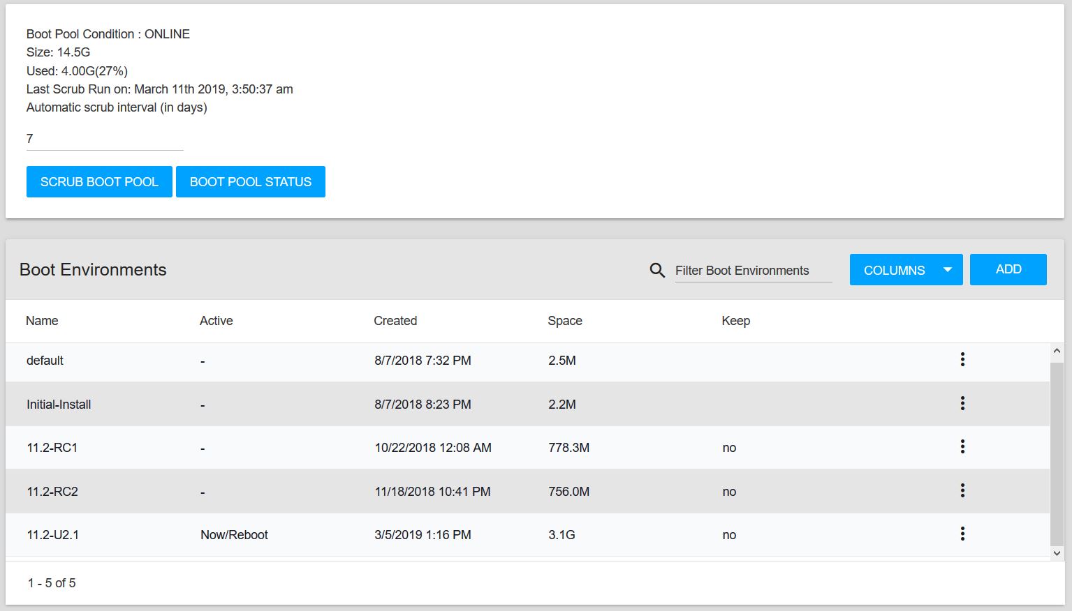

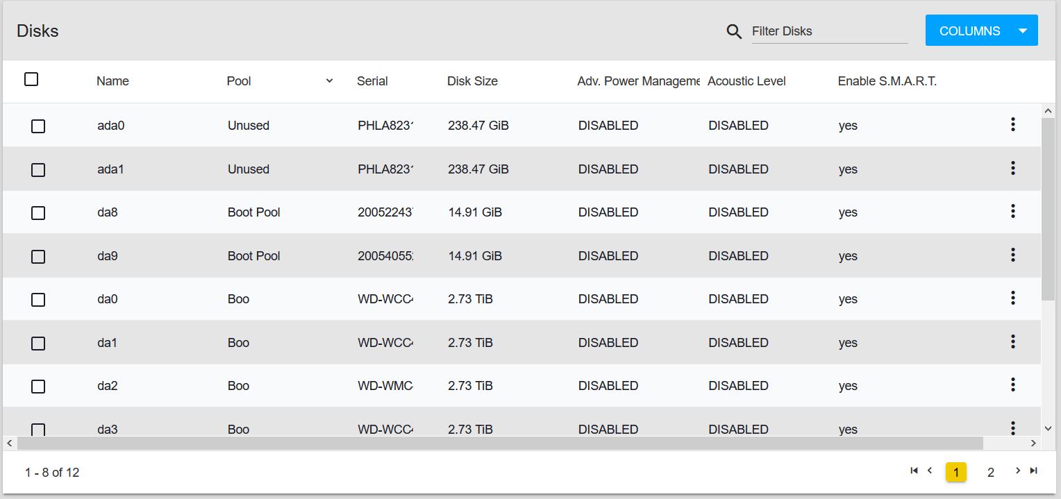

Could someone please help me with a guide on how to move the following to my 2 new 250GB intel SSD's in mirrored mode ;
boot image (currently on usb flash drive )
system dataset (currently on usb flash drive )

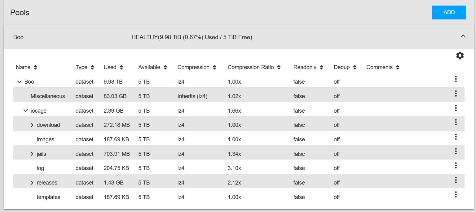

plex jail (currently on main pool)
transmission plugin ( currently on main pool)
At the moment the 2 new drives are installed, but i haven't created a new pool or anything.

You could install FreeNAS on one or both of those SSDs, and keep the .system dataset on the boot pool. Or you could create a new pool on those SSDs, move the jails there (I'm not sure exactly how you'd do that, but I'd expect ZFS replication would do the job), and put the .system dataset there. There isn't going to be any way* to put all three things on those two SSDs if you want them mirrored.
* Well, not any way that would be remotely supported or a good idea, anyway.

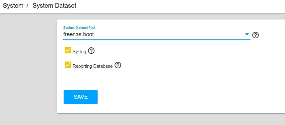

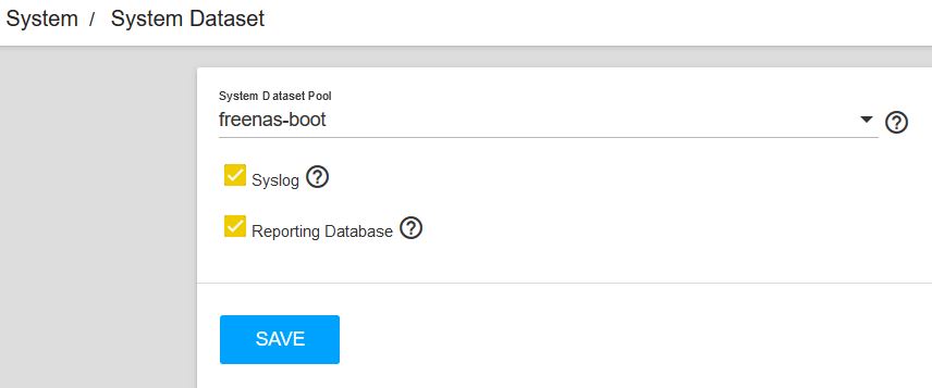

When I changed the .system dataset from my normal pool to the USB sticks a while back I literally clicked the drop down menu in the screenshot below and selected freenas-boot.
Would it be as simple as clicking the newly created SSD pool from the dropdown for moving system dataset to SSD's ?

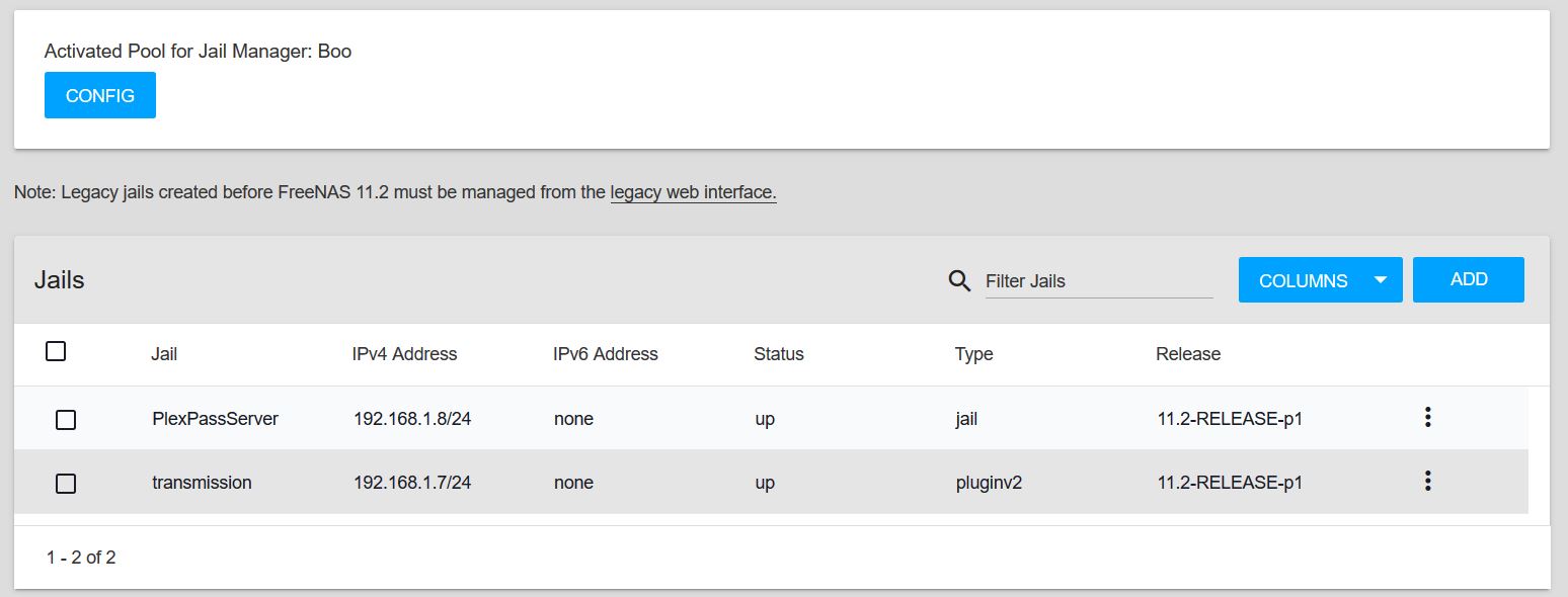

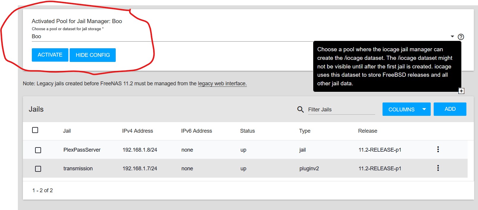

I noticed in the jails menu that there is a similar option and wondered if this would move the jail and plugin to the SSD's also ? here is a screenshot of what i mean.

System dataset: As per the manual, it is as simple as changing the pool in the dropdown. Existing data is copied across, job done.
Jails are not so amenable. FreeNAS supports having jails on several pools, and changing the dropdown will create a new one and activate it but won't move your old jails.
I'm not sure if you can activate jails on the new location, shut down the old ones, replicate them across and expect it to work; or you may need to activate the new location, stand up a new PlexPassServer and Transmission, shut them all down, then copy the content across from the old jails to the new ones, and kill off the old ones.
With my Plex I did it the second way, I just tar'ed up the whole Plex /root/ content and unpacked it to overwrite the newly created one, but I was moving it from one server to another and didn't think of replication. Transmission you might as well just stand up a new one really.
Thanks yes I have now done this.
I am unsure how i go about delteting the old .system dataset though, I can't find anything in the manual or on the forums ?
After many hours of searching i eventually found something on moving iocage jails and it seems to have done the trick :)
Here is the link for anyone else who might need it.
https://www.ixsystems.com/community...ng-the-iocage-dataset-to-an-other-pool.70168/
