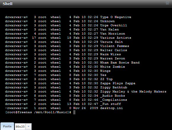

The results of the ls -l are attached. The command returned the folders in the top level share.

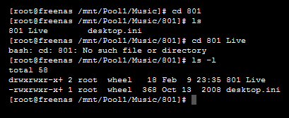

INTERESTING:
The top level share outputs a result for the ls command.
I can cd down into a folder and do the ls but try to cd in the next foler down and 'no such foler' error pops up! (Also attached.)
I have the instructions you cited above and will look at it tomorrow w/ a better eye.
INTERESTING:
Looks fine, matches what you had on your dataset's settings. Maybe it's not a permission issue?
