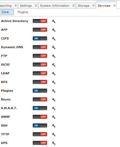

b) upload the FreeNAS-8.3.1-RELEASE-x64.Plugins_Jail.pbi
c) make sure the plugin service is active
now to be on the safe side ...the web page doesn't always tells the truth.
Go to the shell and type
[root@freenas ~]# jls
JID IP Address Hostname Path
1 - software /mnt/DGCOM-Music/jail/software
voila the jail is running and has a JIS of 1

Of course the packages weren't found
exit the jail...
exit
do you have a nameserver in your /etc/resolv.conf?
vi /etc/resolv.conf
some keys for vi "esc" "i" "d" "r" i=insert r=replace d=delete alter between them with the esc key
to save "esc" ":wq!" :wq! is entered at the prompt
to quit without saving ":q!"
so change your /etc/resolv.conf and add nameserver 8.8.8.8 or at the prompt you can:
echo nameserver 8.8.8.8 > /etc/resolv.conf the > pipes the output to a file instead of standard to the screen..
You can also use the gui tab network fill nameserver 1 and IPv4 default gateway !!!
