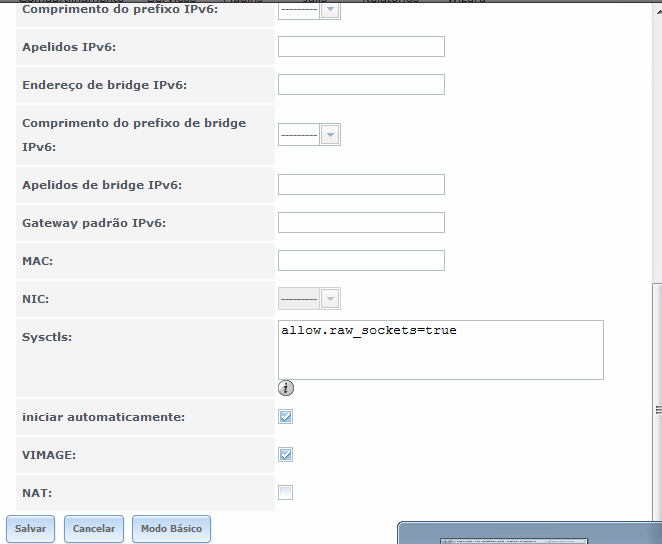

How is the correct configuration of jail network?
I need to check box VIMAGE only and assight static IP?
I note something:
When I does not check VIMAGE, the jail take the network IP but can´t start openvpn.
I only can start openvpn when VIMAGE is checked.
In my case I put 192.168.25.54 as Jail IP and redirect the port 443 to this IP in the router (I use only 443 and not 10011 like in the tutorial).

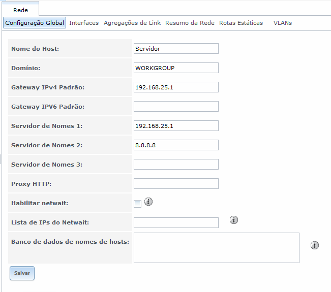

My router is on 192.168.25.1 and Freenas on 192.168.25.55.
Anyone has some tip about it?

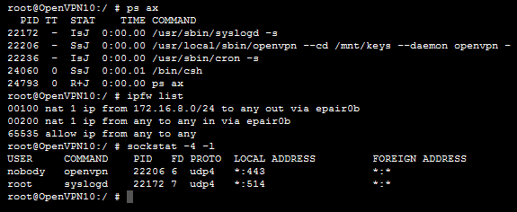

Open VPN is runing and listening the correct port.
I think that one of my problems is that the port ir not opening.
I did the configration again, using 10011 and the same result.
Port is not opening.

I check VIMAGE box after pkg update, upgrade, install...
With this check box I did not get internet.
And if I leave this unmarked openvpn does not start.

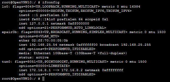

root@openvpn:/mnt/keys # ipfw list
00100 nat 1 ip from 172.16.8.0/24 to any out via epair2b
00200 nat 1 ip from any to any in via epair2b
65535 allow ip from any to any
root@openvpn:/mnt/keys # ifconfig
options=600003<RXCSUM,TXCSUM,RXCSUM_IPV6,TXCSUM_IPV6>
inet6 ::1 prefixlen 128
inet6 fe80::1%lo0 prefixlen 64 scopeid 0x1
nd6 options=21<PERFORMNUD,AUTO_LINKLOCAL>
epair2b: flags=8843<UP,BROADCAST,RUNNING,SIMPLEX,MULTICAST> metric 0 mtu 1500
options=8<VLAN_MTU>
ether 02:ff:70:00:09:0b
inet 192.168.25.54 netmask 0xffffff00 broadcast 192.168.25.255
media: Ethernet 10Gbase-T (10Gbase-T <full-duplex>)
status: active
tun0: flags=8051<UP,POINTOPOINT,RUNNING,MULTICAST> metric 0 mtu 1500
options=80000<LINKSTATE>
inet 172.16.8.1 --> 172.16.8.2 netmask 0xffffffff
