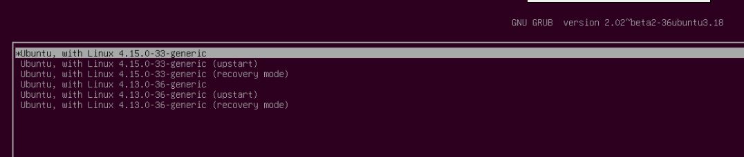

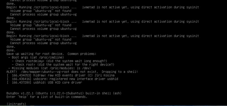

Anyone having issues with this? I have had it running for sometime, but now for some reason Ubuntu will not start. I even did a reinstall, went through the entire setup, after it said to remove the boot device (or whatever) I rebooted. I get to the screen where I can choose from the following:
Ubuntu, with Linux 4.15.0-33-generic
Ubuntu, with Linux 4.15.0-33-generic (upstart)
Ubuntu, with Linux 4.15.0-33-generic (recovery mode)
Ubuntu, with Linux 4.13.0-36-generic
Ubuntu, with Linux 4.13.0-36-generic (upstart)
Ubuntu, with Linux 4.13.0-36-generic (recovery mode)
But it seems no matter which option I follow I get no where.
I am running 11.1-U6

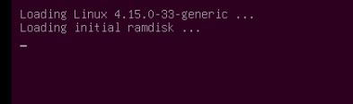

This is where I start from:
In this example I selected the first option and it freezes here:

When I go into recovery mode I get the following at the end:
Hi there, the problem is that the latest patched version of UBUNTU v16.04 has had an updated linux kernel (v4.15) which the Bhyve virtual engine in FreeNAS doesn't support. The Bhyve engine has been patched by FreeBSD but wont be in FREENAS until v11.2 (well, that's my understanding).
It's a real pain, as if it was working and you then ran the patcher within the UBUNTU install, it suddenly stops working :(
The way round it, for me, was to start afresh and use UBUNTU v14 which works fine with CrashPlan and uses an old linux kernel so doesn't have a problem with Bhyve.
I will edit the guide to clarify this for people.
Yours
Jonathan

Hey All,
I thought it was just me! Rebooted the NAS and my (Ubuntu 16.04 ) VM wouldn't come up, what the heck?
But I can confirm through a few hours of testing and trying, what Hazimil is saying about the 4.15 kernel not working. I got mine to boot on 4.13, however only with manual intervention, here's how:
If you can't get to Grub, follow: https://forums.freenas.org/index.php?threads/freenas-11-0-rc3-vm-doesnt-boot.55028/#post-384444
In Grub choose the first 4.13 kernel (and if that doesn't work, choose the last 4.13) and "Recovery Mode"
In recovery mode, just choose normal boot. I didn't have to use any of the other options and it booted to the desktop.
Once booted, I did a
sudo apt-get -y update && sudo apt-get -y dist-upgrade
sudo apt autoremove
For reasons I can't explain, this kept me on 4.13 kernel
Next edit Grub to remove the 4.15 entries (or move them down), and move the upgraded 4.13 kernel to the top. There is a handy tool for that if you don't want to mess with vi or nano: https://launchpad.net/grub-customizer
Reboot and see if it boots straight to the desktop. It still does not for me, but if i choose recovery and normal boot, I get right in. For now I have moved recovery mode to the top/default option in Grub.
If I find the fix to that, without re-installing, I'll report back.
Andrew076
Apr 5, 2015
206
Thanks. That (using an iso for v14) did it I have ubuntu and running now, but I can't seem to remember what I did to see the files in the folders I need to mount. Following the directions last time didn't work for me.

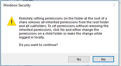

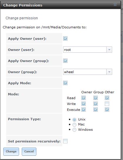

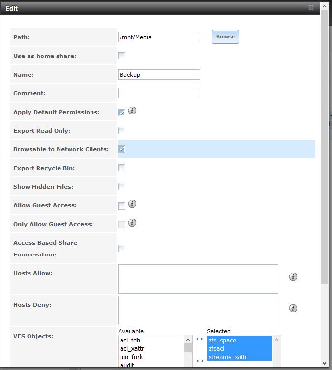

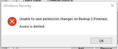

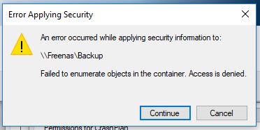

Okay, still no where close to figuring out the "Issue" but I think I have narrowed down the problem. First I deleted all my windows shares, and the crashplan user so I could start from "scratch" however I can't get past Step 5 now which leads me to believe that was my issue all along.
Here are the steps I took till I ran into the problem:
I created the CrashPlan:
Then I created a new Windows SMB Share, and named it Backup:
But when following the Step 5 and try through Windows Explorer, to grant the user CrashPlan user access to the Backup shares , using “Read & Execute, List folder contents, Read” permissions. I get the following error messages:
I will point out that when I went one level down and tried the same thing, i.e. on Backup\Documents I got the same error messages.

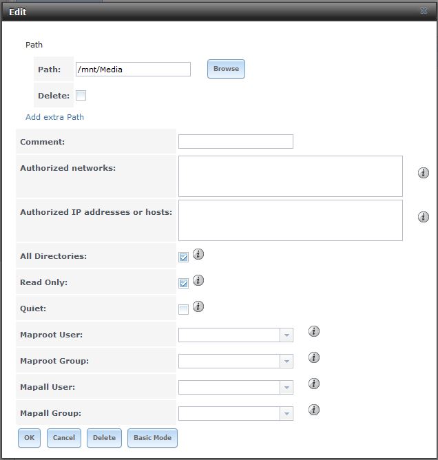

Have you tried with NFS instead of SMB? I posted a NFS version of this how to here: https://forums.freenas.org/index.ph...rashplan-6-6-w-o-losing-your-jail-backups.78/
Thanks, I tried using the "NFS" method.
See how I setup the NFS Share.
Then I mounted as you said. Then I tested it, I could get to Media, and under media I saw my main folders "Documents, Pictures, Videos" so it did connect and mount. But, when I browsed into Documents there were no files.
