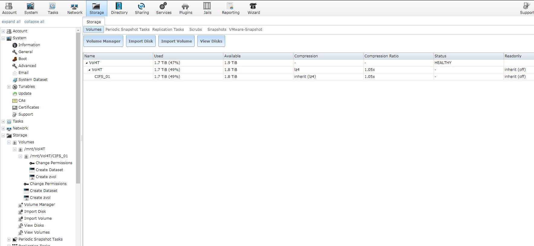

Sep 15, 2017
56
Here is the screenshot of the storage tab. Let me know if any screenshots needed here.

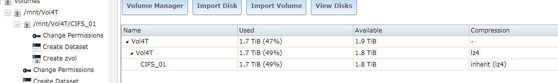

15,504
Can you post another screenshot with CIFS_01 highlighted? When you click on it, some buttons should become visible at the bottom.
Edit: Whatever CIFS_01 is, it isn't a "vol". There's no such thing as a "vol" in FreeNAS. There's a zvol, which you'd share using iSCSI (or use with a VM), and there's a dataset, which you could use for any number of things.
What's your problem? According to your screenshot you have created something, most likely a dataset, named CIFS_01 under the Volume Vol4T. Again according to your screenshot your "thingy" called CIFS_01 has used 47% of the avavilable storage (1.7 TiB) leaving 1.8 TiB available for "thingy". As 2 x 4 TiB in mirror leaves you with less then 4 TiB usable storage I would say that you are good.
By the way: Let's assume that CIFS_01 is a dataset. Then it is possible you have set a value for quota for that dataset. If that is the case you can set the value of quota to 0. That way your dataset can use all the available space. Read the Freenas manual to find out more.
For now, I am good. Thanks for everyone's input here.
