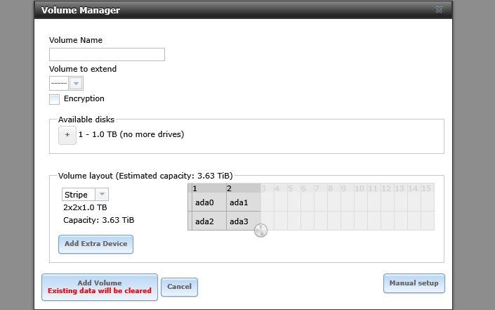

ashokmedia
May 26, 2019
11
There's no such thing (the closest thing I can think of to that terminology would have traditionally been called RAID 10, and with ZFS is called striped mirrors, but that wouldn't be any flavor of RAIDZ, and also isn't what you had). What you appear to have had was four disks striped, with one of the disks now missing or dead. Unless you can revive that disk for at least a while, your data is gone.
15,504
yes this is how i created
The output of zpool import indicates that you're mistaken. That output indicates that you had three disks (which are available to the system) striped with at least one more (and from the rest of your post, almost certainly exactly one more). You had no redundancy in that configuration, so with the loss of one disk all the data in your pool is lost. The only way to get any of your data back is to bring that disk back online, or to restore from backup.
garm
Aug 19, 2017
1,556
To get mirrors you needed to select “mirror” in the creation dialogue drop down. You show “stripe” and thus you will create a striped pool, regardless of how many rows of disks you have.
