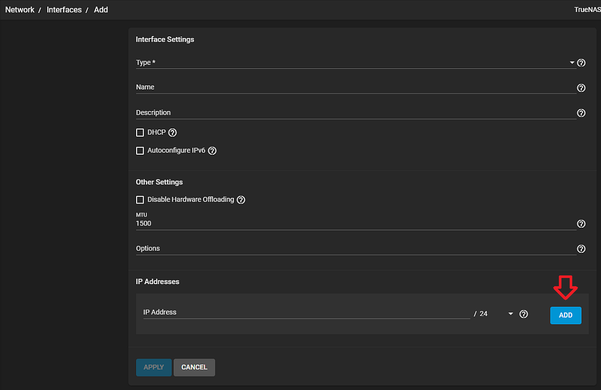

scope:link is used for secondary subnets off the primary interface. For TrueNAS, OP will need to manually add interface IPs on those secondary subnets.
