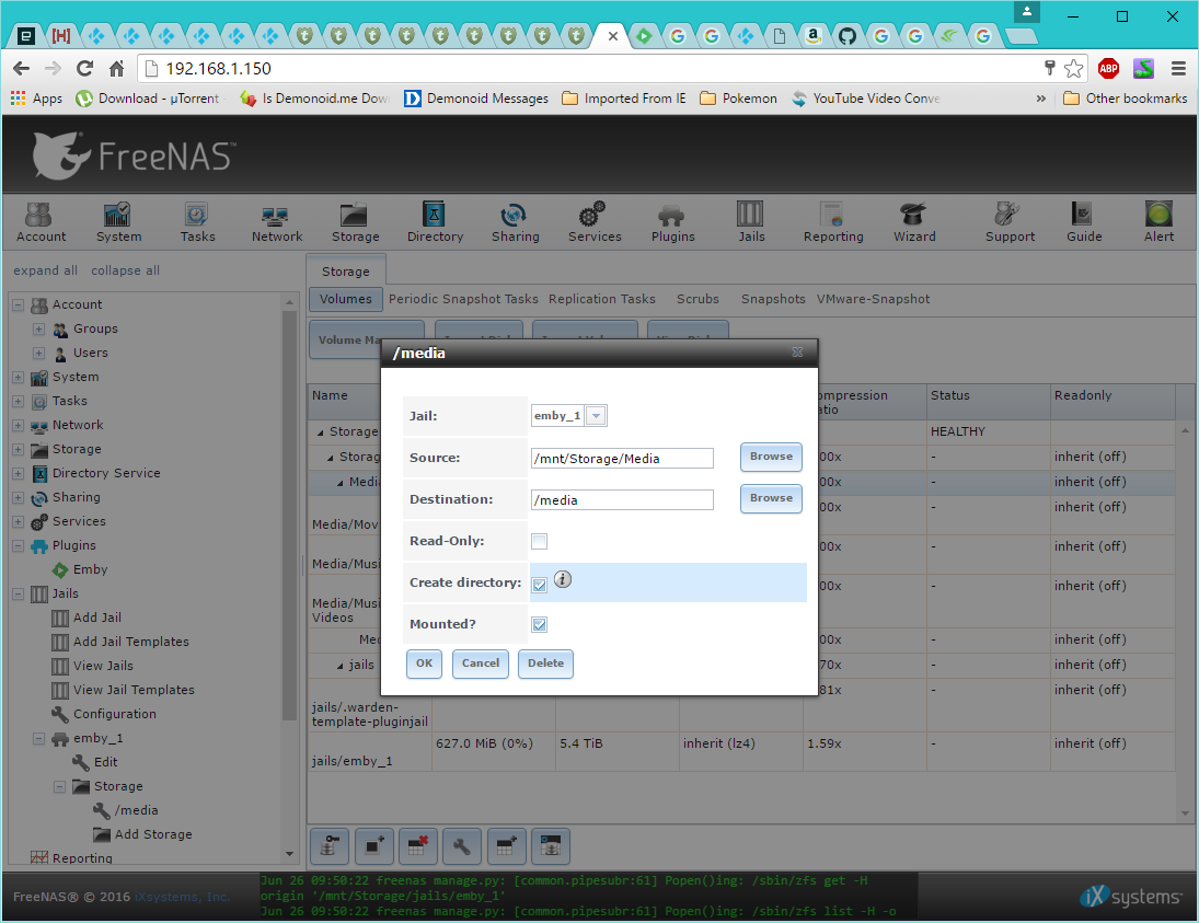

I could really use some help setting up the Emby Plugin.
I'm very new to this, but was able to read through tons of forum posts, and setup a very good freenas box (48TB of storage), which I share via CIFS to several Windows boxes, and a Nvidia Shield TV.
I have setup the shares (/Storage/Media/Movies and /Storage/Media/TV), and everyone has access to them no problem (user: nobody, group: shareusers). On the Windows systems I can browse to the share using \\freenas\Movies or \\freenas\TV.
Again everything so far has been working great. Now, onto Emby. I followed several posts on how a basic setup of Emby should be, but they all seem to be missing several steps that a newbie like myself needs to complete the setup.
First thing I did was install the plugin (piece of cake).
Under Jails, the emby_1 Storage/media looks like this...
I'm able to start the Emby plugin, and go to the webpage listed (192.168.1.102:8096) without issue.
The problem happens when I try to add the content to Emby, it doesn't seem to recognize my movies path (/mnt/Storage/Media/Movies) and gives me the following error:
"There was an error adding the media path. Please ensure the path is valid and the Emby Server process has access to that location."
I've tried dozens of different (/Storage/Media/Movies, or /Media/Movies, etc) ways to add this storage, and all give the same error.

You've created datasets for each subset of media? You might be better served leaving your storage pointing to media and then creating directories for each subset in the media folder for your shares to pull from rather than separate datasets.
Also, you may have to change your destination to "mnt" for your attached storage.

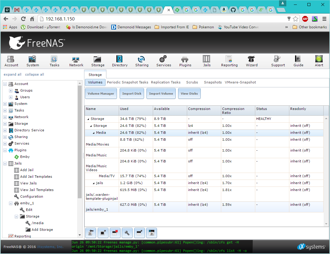

So how would I go about changing to a single dataset, with folders (I thought this was how I set this up). The screenshot of my FreeNAS storage doesn't actually look like that, I actually see something like this.
-Storage
--Storage
---Media
----Media/Movies
----Media/TV
----Media/Music
----Media/Music Videos
---Jails
----Jails Warden...
----Jails/emby_1
So in the screenshot, it looks like Storage and Media/Storage are on the same level, but in reality, Movies, TV, Music, and Music Videos, all reside under Media.
I think it looks different in the screenshot, because I shrank the screen down.
-Storage
--Storage
---Media
----Media/Movies
----Media/TV
----Media/Music
---Jails
----Jails Warden...
----Jails/emby_1
if you have data in any of the subdatasets of Media, back it up somewhere.
delete all those subdatasets, and create folders instead in their place. restore data you previously backed up.
BBarker
Member
Aug 7, 2015
120
You need to create one dataset in your storage pool and call it "media" (assuming that is the name you want to give it).
Depending on how much data you have distributed over your dataset(s) this may require you to back all your media up from all datasets to a secure location, destroy the datasets that are subsets of "media" so all you have is the one dataset called "media" remaining. This will be the root folder that all your media sub folders will be kept in and sorted. Keep in mind that when you destroy a dataset, you lose all the data you had in that dataset so it's important that you have all your files securely backed up before you start this process.
Check to make sure that your CIFS shares points to the "media" dataset and not the other datasets you just deleted. Access your media folder using a windows machine with your CIFS share and create folders for the different types of media files you will be storing there like "Movies", "TV Shows", "Music", etc. Now you can restore the media that you have backed up to the appropriate folders you just created within the media dataset. When setting up plugins and other computers to access the "media" dataset, you can now point them to the correct folders within your dataset to pull the information from.

Hmm, originally I thought that's what I did, created the Media share, and then created folders within that share. Being a newbie, obviously I screwed up. However, couldn't I fix the permissions on the Media dataset, create the folders for (Movies, TV, Music, Music Videos). Then copy each subdataset (Media/Movies, Media/TV, etc), into the newly created folders under Media?
BBarker
Member
Aug 7, 2015
120
I think you may be confusing folders and datasets. It shouldn't be a problem to create folders within your media dataset with your windows machine and then move the files over from the individual datasets into the new folders using the same machine as long as you have your CIFS shares pointing to the "media" dataset instead of each individual dataset now currently set up. Once done, delete one of the sub datasets and confirm that the new folder is not effected before deleting the other two.
Having your files backed up is always a good idea just in case you destroy the wrong dataset!
Your freenas machine will have a pool called "Storage" with one dataset called "media" when you are finished (jails are separate and will still be showing in their current location which is fine). Your windows machine will will browse the "media" dataset at \\freenas\Storage\media and should show all the newly created folders and their corresponding data when you open them.
Matt Bennett
Neophyte
May 11, 2016
5
Just as a followup, I followed both BBarker and Joshua's advice, and created folders under the "Media" dataset, and this fixed the issues I've been having with Emby. It was almost too easy, and I didn't have to delete anything, just created the new folders, and moved everything to them (took quite a while though).
Thanks for all the assistance, it is appreciated.
