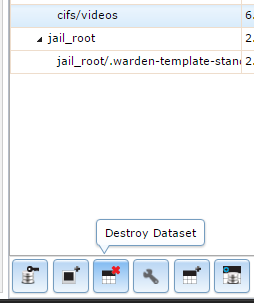

So all you "folders" are inside one dataset and they are the only data inside that dataset? If so you can destroy the dataset. Be aware that everything inside that dataset will be erased.
Please be 100% sure of what you are doing before proceed.

There is no such thing as formatting a dataset. You can create and destroy datasets, and you can do whatever you want to their contents, but the concept of formatting one simply doesn't exist.

When the manual use the word "format", I just thought that I could do a "format C:" like on Windows.
But I'll destroy the dataset and create a new one.
