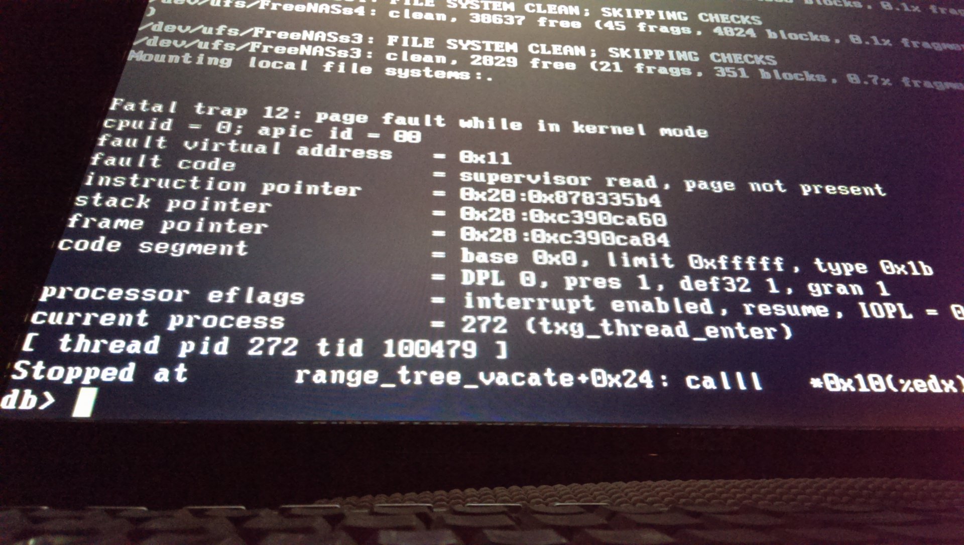

Arhoover
Neophyte
Jan 26, 2014
5
I followed the steps all the way up to the reboot without issue.
After attempting to boot with the new rc.conf file modifications (the following step)
enable the variable so the script runs at boot:
nano /conf/base/etc/rc.conf
add:
mountproc_enable=”YES”
edit rc.conf to load linux module at boot (in FreeNAS)
mount -uw /
add:
linux_enable=”YES”
reboot FreeNAS
So now I am stuck with a
Fatal trap 12: page fault while in kernel mode
cpuid = 0; apic id = 00
fault code      = supervisor read, page not present
Stopped at range_tree_vacate+0x24: calll
db>
the "db>" allows for some command line access, but I'm unclear how to undo the previous rc.conf file additions.
Help?
J
jkh
Guest
Wow, nasty. Your kernel has panic'd - there's definitely nothing more to do there! You're done - reboot the box!
This is, in a nutshell, why jails are essentially a stop-gap until we manage to get something like bhyve to replace them for plugins. It's all very very fragile and subject to some pretty strong limitations in both the jails and linux emulation code, which is definitely showing its age (and obsolescence) in FreeBSD.
Arhoover
Neophyte
Jan 26, 2014
5
Looks that way!
So my question is this: What's the next step?
Two things I can do:
1) Re-install Freenas, and load my configuration. Maybe this is the easiest and best path.
2) Edit the rc.conf file. Any advice on how to do this without getting into the system? Is there a rescue mode I can get into in order to do this?
Thank you for the help!
Arhoover
Neophyte
Jan 26, 2014
5
For reference, here is a picture of what the Fatal trap looks like on the console:
J
jkh
Guest
I would start with FreeNAS 9.2 (if you're willing to go to 9.2.1, the current nightly is very close to Release Candidate status) and then try the Crashplan plugin there. It's not easy to set up, but many folks in the forum have managed to do so, so we know it's at least *possible*. :)
