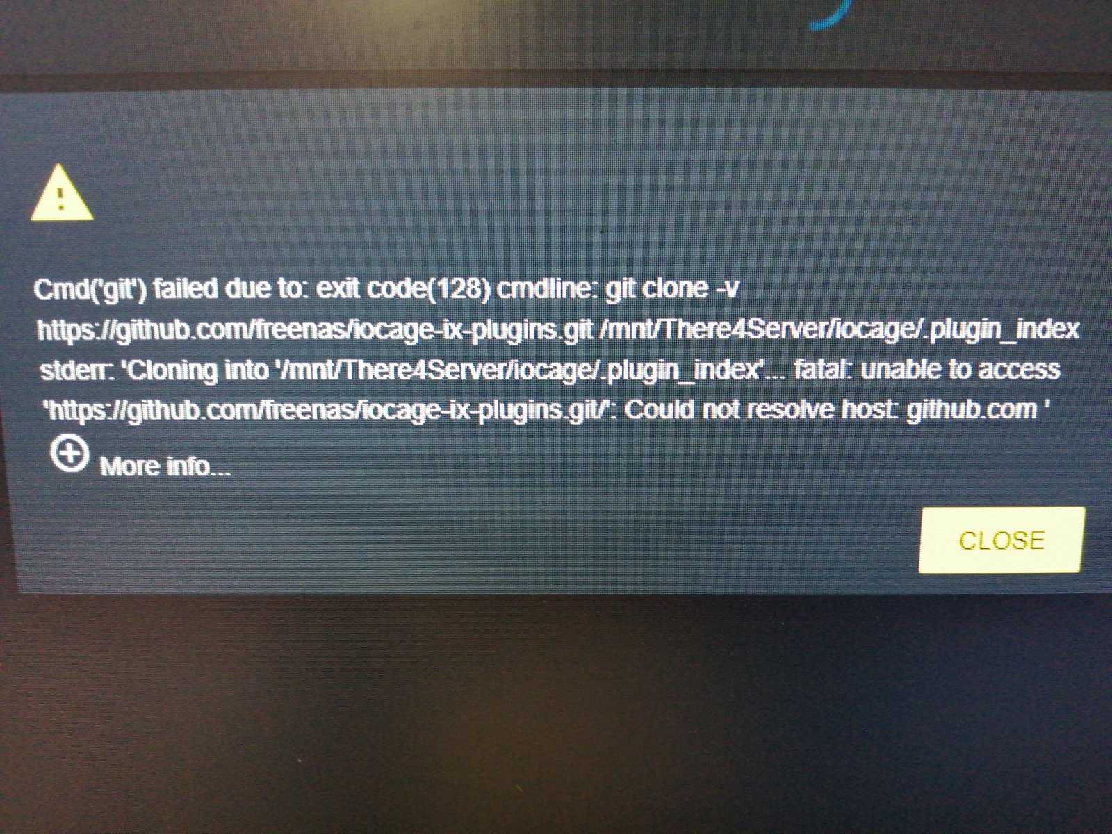

Wanted to try this out... But now the next problem arrives... This would have been my first time installing a plug in and as soon as I go to the plugin menu and select Available. It sends out an error "cmd('git' ) failed due to: exit code(128) cmdline: git clone - v" blah blah blah

Again, don't use the plugin. See my edit above for an alternative (and IMO better) way to install Nextcloud. The plugin is broken and iX haven't shown any interest in fixing it.
It seems you have a network configuration issue, as the DNS resolution for your server isn't working.
There are several threads addressing that same issue, do a search on how to configure your network.
My personal choice is set the network interface with DHCP and let the router to the job; later on fix that IP inside your router so won't change.
Afer that do some tests with available plugins to learn how to do things. When having a stable plugin running, you can make it official and share with your family and friends.
As above, do not open the smb ports to the internet, as that is a receipt for your data be accessed by other people; that's true for the GUI, ssh, etc. Only open things you know how to control and know the impacts to your server's security.
not use the Nextcloud plugin.

It seeeeems to be stuck at installing plugin...
15,504
Is the plugin not working?
To be specific, here are the issues that (IMO) make it "broken":
  • Installing the plugin doesn't actually give you a fully-installed, working Nextcloud instance; you need to log in to its web UI and enter the database and admin user credentials. This is trivial to fix; I put in a pull request back in May that takes care of it. They haven't touched it.
  • In apparent preparation for UI changes that should be coming with FN 11.3, they've removed the database credentials that used to appear in a one-time-only pop-up window (that you then had to enter into the web UI) and moved them into a text file that lives in the jail. To find those credentials, you have to drop into the shell, enter the jail, and view the contents of that file. It's literally impossible to get the plugin working without going to the shell.
There are other deficiencies that don't rise to the level of "broken" but should still be addressed; foremost among those is the complete lack of TLS/SSL support. Sure, you probably can't get a Let's Encrypt cert for the instance (like I do) without requiring user input, but even a self-signed cert would give you the rest of the configuration.
