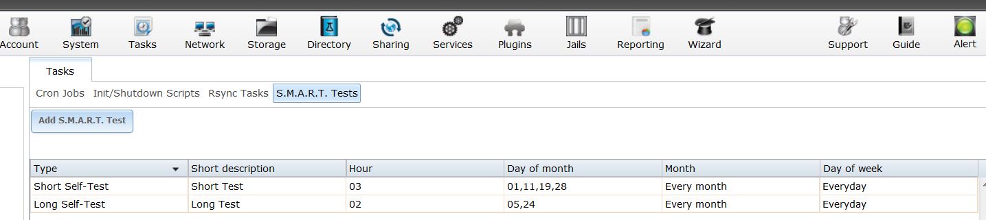

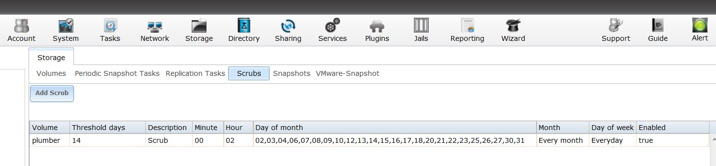

Here's my settings for a 6 disk (3TB) RAIDz2 volume
How often you run the tests is purely a personal thing, I just tried my best to make sure the scrubs and tests don't conflict with each other.
I know this is an old thread, but I'm revising my scrub schedule and was trying to figure out what others are doing. Mike360X1 is expecting to run his long/short SMART tests on different nights than his scrubs. He is attempting to do this by specifying the days of the month, but also specifying the days of the week. However, according to FreeNAS documentation, the Day of Week
field and the Day of Month field are ORed together: setting Day of Month to 01,15and Day of week to Thursday will cause scrubs to run on the 1st and 15th days of the month, but also on any Thursday
If I apply what the documentation says to the way Mike has set it up, Mike's scrubs are being performed on every day of the month - even on days he has not specified using the Day of Month field. This is not what Mike (or most other users) would expect. Am I misunderstanding, is Mike misunderstanding, or is the documentation incorrect?
The way to prevent this would be to not require the Day Week of Field when Day of Month is specified. However, Day of Week is required no matter what Day of Month is set to. Seems like a bug?

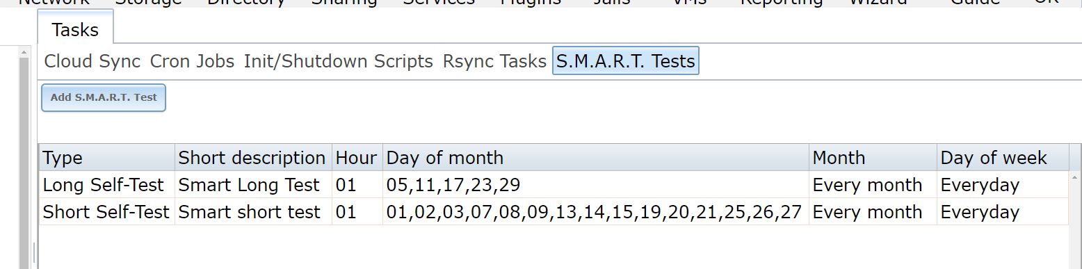

The picture above is of my current SMART settings in the GUI Tasks tab,
the output below is the SSH results for upcoming SMART tests.
Please note that if you specify days, that Days of Week must all be checked or tests will be skipped
due to dates occurring on different days of the week throughout a 12 month period.
