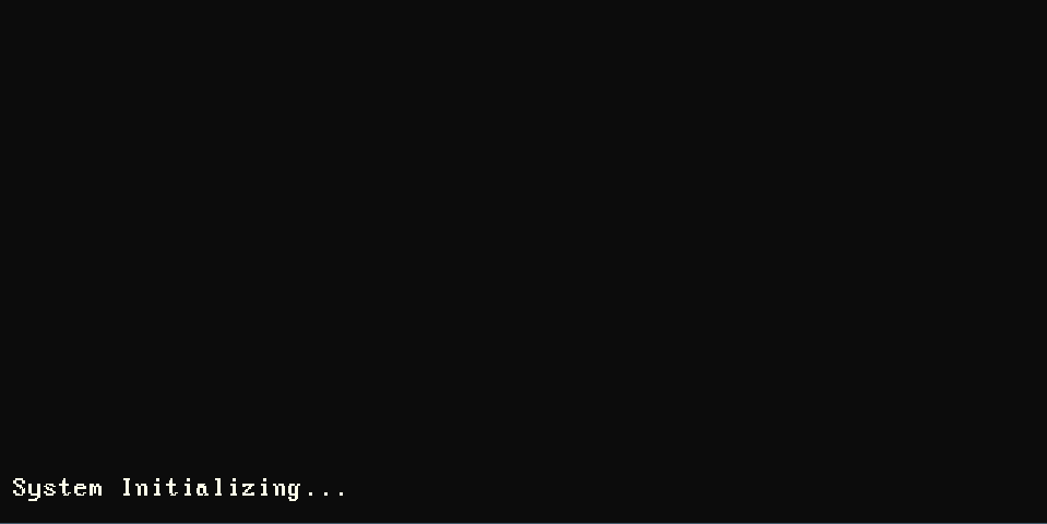

Got my C2550D4I Feb 2017. It was running almost fine (except the battery kept dying). Today freenas was not accessible and frozen, A hard reboot later I was able to boot but after unlocking the encrypted pool everything froze again. From that point during reboot the fans start for 3-4 secs and stops, no POST, no VGA. Removed battery, disks and RAM, used one RAM (on different slots), used a different PSU without any difference/luck. The BMC LED1 flashing and IPMI is accessible but there is no way to revive it.

I'm sorry you too got bitten by the bug. I hope ASRock will send you a replacement ASAP.
Seeing that I've cycled through about 4 boards or so before I had a working solution, keep an eye out for the motherboard revision (v1.03 seems to be safe - look for the silkscreening near the PCIe slot) and the version of the BIOS they're sending you (p0.035 is the one you want.) That way, you can salvage the RAM and the rest of your server setup.
Also, be very. careful with your RAM as you handle it between boards. I must not have been as careful as I should have been as two of my memory sticks went bad - one with occasional, but correctable, ECC errors, the other so bad that the machine would not POST. That was pretty painful since these sticks were the unobtanium 16GB UDIMM variety pretty much custom-made for this series of Atom processors.

For posterity, here's what you'll see on the screen when your C2550D4I or C2750D4I dies. It will stay on this screen forever.
