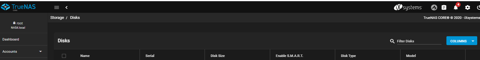

Your plan won't work. FreeBSD used the drive's gptid for identification - the adaX and daX designators are "arbitrary" and may change on reboot. FreeNAS/TrueNAS report the drive serial number and that's what you'll use/check to pull drives for exchange, etc. Make sure the serial number is visible on the drive when installed - if it isn't visible put a label on it that is.

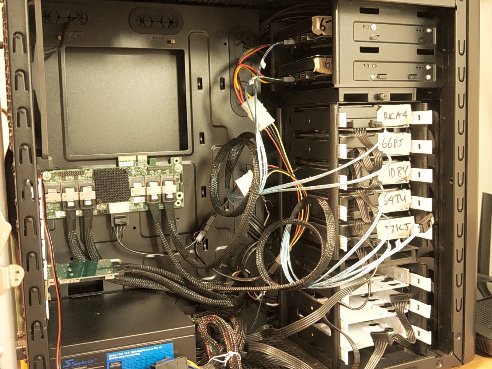

Not my system, but a handy example of how someone else did it. Click the image for a better view and note the masking tape labels on the drives. Usually, the last four digits of the serial number is all you need for uniqueness.
If you have a SAS expander bakcplane, you can just tell it to blink the light to tell you what drive to pull. That is very helpful when you have a quantity of drives.

If a drive should fail in such a way that it disappears from the list, you can find the faulted drive by process of elimination. This doesn't happen often, but I did have it happen once. When the drive faulted it was as if it had been unplugged. It was just not showing up at all. I found it helpful to have a printout of the list.
