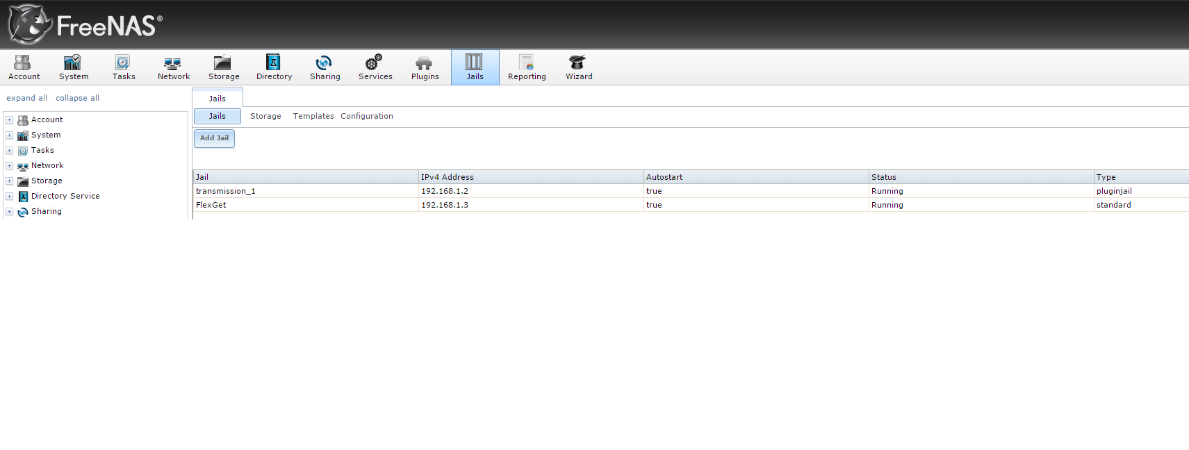

I have done every thing I could think of and I still can not get flexget to work.
I have deleted every thing
I re-install the OS
I now have a jail for flexget and I run the scrip and commands as you mentioned and still it would not work. What the hell is with this version. I am thinking I need to stop upgrading as it has always been problems.
This is what I am getting not. It is not from the script but I would show you the same message I got and what is up to date.

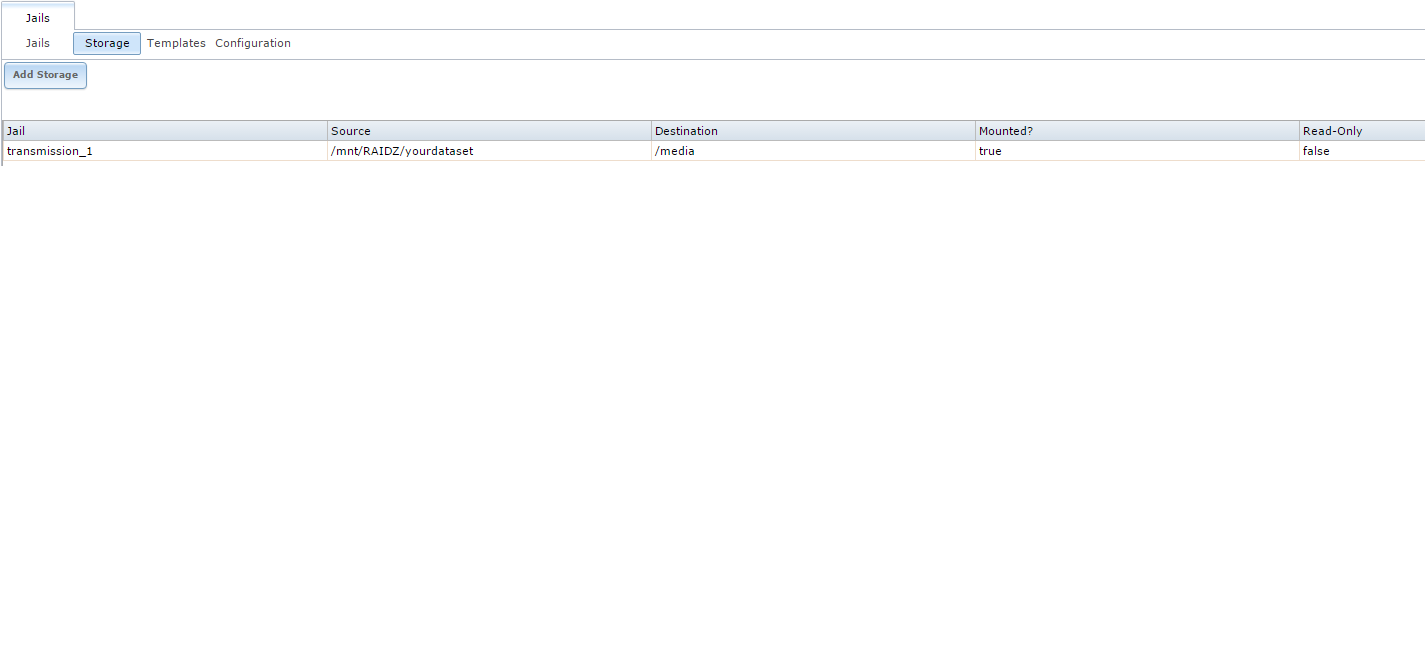

rexzar
Mar 11, 2016
Good evening!
I'm fairly new current FreeNAS but has followed this guide from freenas videoguid : https://www.youtube.com/watch?v=lyW7BpKfBmk to configure my transmission application.
I was now lokking to get flexget to work with all this but need som more information.
I have followed your installation guide Scharbag. Created a new standardjail and installed flexget with this result:
[root@freenas] ~# jls
JID IP Address Hostname Path
3 - transmission_1 /mnt/RAIDZ/jails/transmission_1 JailIP:192.168.1.2
4 - FlexGet /mnt/RAIDZ/jails/FlexGet JailIP:192.168.1.3
root@FlexGet:/ # flexget -V
1.2.480
You are on the latest release.
The only thing I want now is to create a config.yml where I can get the connection to my transmission client and just add an RSS link. Do not need to have any quality filters and so becouse all filtration goes through the rsslink.
From the youtube link transmission is configured to add all my downloads in /media from the pluginjail, so when i goes to \\freenas i can see all my downloads there.
So I want to have an example of the .yml file their all the downloads from rss link autostart in my transmission client. And shows up directly as when iam add torrent manelly from webb interface
Ps: I have creath the: ~/.flexget/config.yml in FlexGet jail I only need the configdata:)
Hope some one can help me:)
Thanks in advance!

Scharbag
Feb 1, 2012
620
Check out the cookbooks at FlexGet.com. There are some good guides on setting up FlexGet with Transmission.
Cheers,
