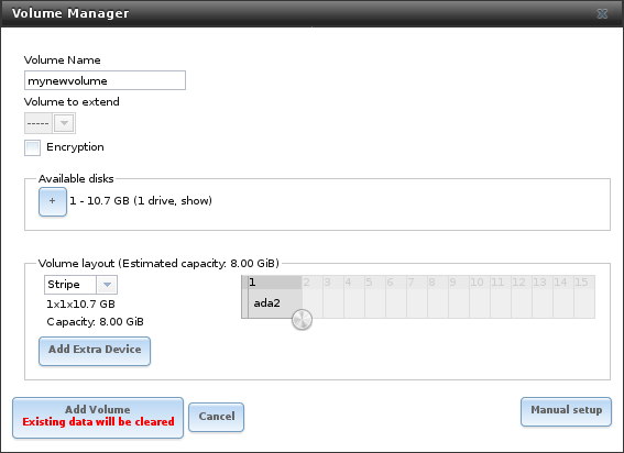

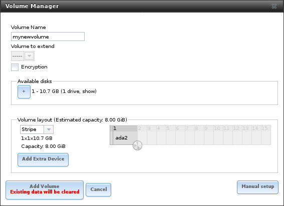

It's not a spare. A single, non-redundant drive is called a "stripe":
Note how it is given a new name, "volume to extend" is left unset, and the Volume layout thing says 1x1. The slider was dragged so only one disk was selected, because I have a couple of spares on that testing system.
Again, having non-redundant disks like this is dangerous. Don't put any data on it you do not have backed up somewhere else, because when that disk dies, everything on it will be lost.
