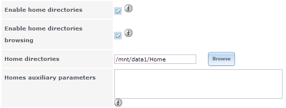

CIFS has Home Directories enabled to the Home folder path.

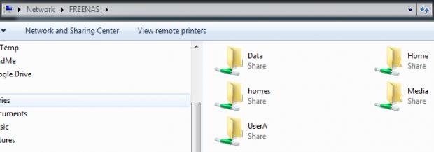

1. There is a "homes" folder when connecting to the share. I am not sure how it go there but am unable to remove it. When trying to connect I get: 'The network path was not found error'. I would really like to get rid of this if this is not an expected result.

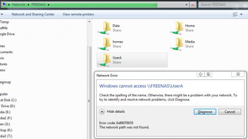

2. When trying to enter the main share folder for the user it gives me an error with the same network path not found error.

Doesn't really figure out what the issue is, but if you ssh into the server, you'd probably be able to remove the homes folder as the root/sudo user. Another possibilty.... if you click on the services tab and edit the CIFS settings, there should be an option called "Enable home directories". If it's enabled for some reason, try disabling it.

Took a look and saw the a directory does not exist error.
So I created /mnt/data1/Home/usera as the log was looking for and like magic it worked. Not sure why it had to be this name. Seems like I should be able to set it to whatever. Thanks for showing me where those logs are!

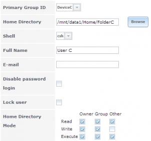

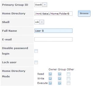

Well I had originally created the folder 'FolderA' and set the UserA home directory to that. I thought that would then use 'FolderA' as the home folder and the UserA folder I saw when connecting to the FreeNAS network location was a virtual folder to the FolderA. Not sure if this is common Unix knowledge or I missed it in the setup guide but if not would be nice to have a walk through doc on getting this set up.
Any ideas where to find the unicorn like directory that is that 'homes' folder?

Got it. My guess is that when u checked the "use home folders" in the CIFS settings that it linked the folders together. That's my best guess. As for the "homes" folder, I'm gonna have to think about that one some more. My first instinct was to check it out on the command line, but if you can't see there, then that's really very weird. I'm actually encountering something on my freenas right now where CIFS and NFS are behaving differently. Perhaps if you can try connecting through a different service and see if it still shows up. If it doesn't perhaps we can narrow it down to a CIFS error.

For some reason I too have a 'homes' folder that has appeared. I have re-installed FreeNAS 3 times now and played with various configurations for Users/Groups and also trying to share via CIFs. The first couple of installs, each with all sorts of configurations tried out (sorry I can't be more descriptive than that as I've tried out so much stuff in the last week or two that I'm confused as to what works and what doesn't ) this 'homes' folder never appeared. Now it has and I'm not aware how.
