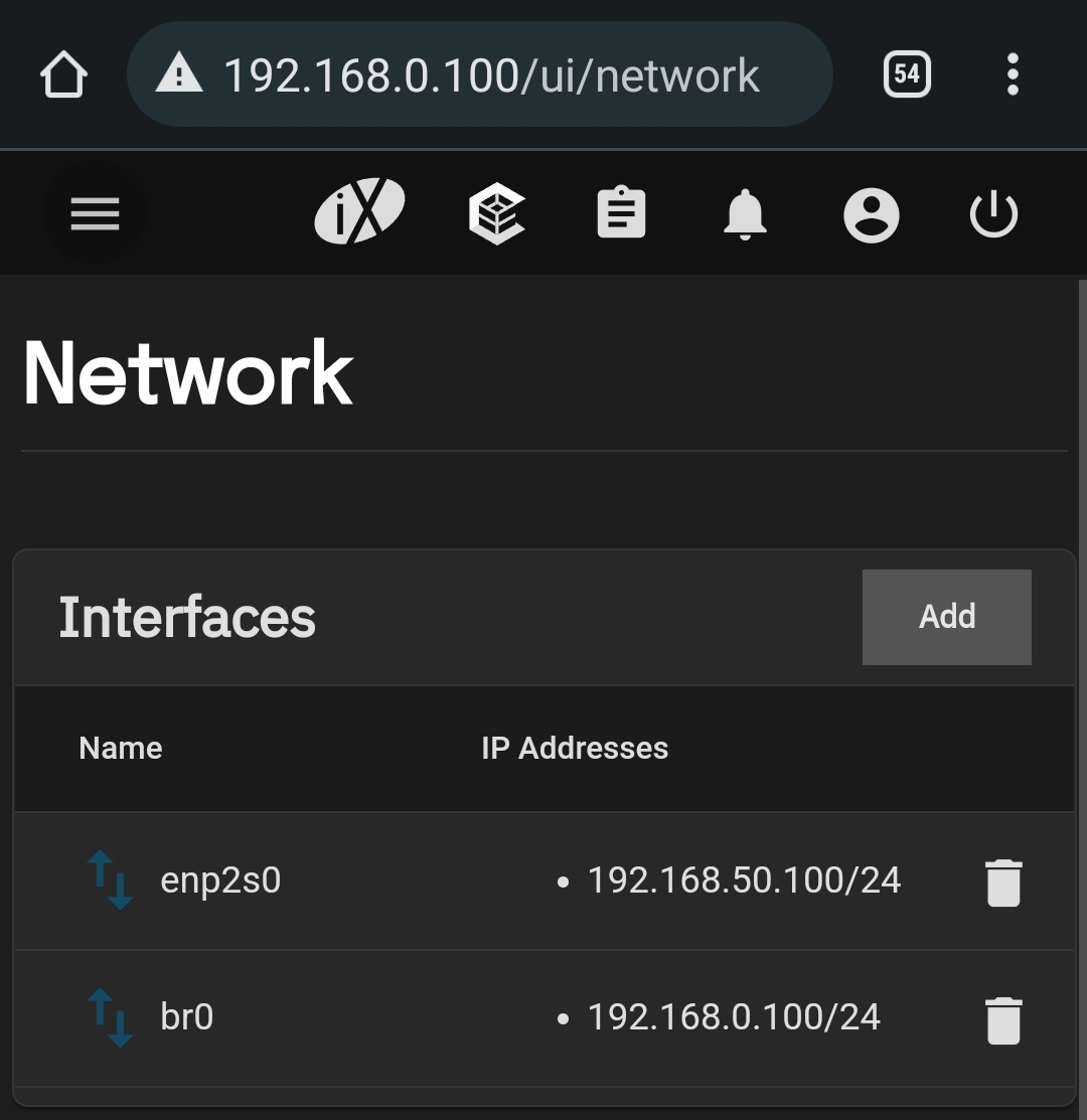

avvd
May 28, 2022
5
It is fixed, here is the solution:
I needed to added a bridge interface to make it work. Adding the bridge wasn't strait forward. Using the guides is caused some issues as the bridge interface didn't came up. So I added a different subnet to the main interface and the right subnet to the bridge interface. The bridge didn't came up until I rebooted Truenas (I found some other discussions in this forum where was discussed if it was a bug or a feature).
After the reboot the bridge automatically came up and I was able to delete the second subnet and IP from the main interface. Now the mdns is working in the vm's.
avvd
May 28, 2022
5
After setting the Bridge interface to the 'main' ip adress and a second subnet (which I don't use) to the nic itself it is working, the vm's can also see the mdns broadcasts
avvd
May 28, 2022
5
See screenshot, the 192.168.0.0/24 network is the network I use, the br0 interface is linked to the vm's.
