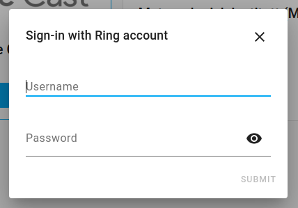

Is you Home Assistant update to date? I just updated from 0.118.4 > 0.118.5 and tried to add the ring integration a second time. This time I have no errors in my log and get a sign in window... I am unable to proceed because I do not have a ring account.
Please try upgrading Home Assistant from the jail's console and try again - (There a simple menu to help you upgrade)

Nice! It works now. All installed.
