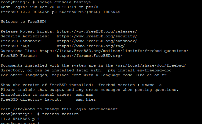

So I tried your command but using 12.2-RELEASE as the version. The new plug in (named testeye) accepted cameras and seems to work.
However, when I get into that jail console and run 'freebsd-version' it reports the jail being 11.3-RELEASE-p14 (as does the TrueNAS GUI) even though the creation steps indicated it would use 12.2-RELEASE (of which I have several other jails running that version)

This makes me think I'll have to try again another evening using the brute force json method to test compatibility with 12.2-RELEASE.
Thank you for the help !

I thought that fixed worked until I ran freebsd-version in the jail...
root@thing:/ # iocage fetch -g "https://github.com/ix-plugin-hub/iocage-plugin-index" -P "motioneye" -n "testeye" -r "12.2-RELEASE" dhcp="on" vnet="on" allow_raw_sockets="1" boot="on"

root@thing:/ # iocage console testeye
FreeBSD 12.2-RELEASE-p2 663e6b09467(HEAD) TRUENAS
Welcome to FreeBSD!
Release Notes, Errata: https://www.FreeBSD.org/releases/
Security Advisories:   https://www.FreeBSD.org/security/
FreeBSD Handbook:      https://www.FreeBSD.org/handbook/
FreeBSD FAQ:           https://www.FreeBSD.org/faq/
Questions List: https://lists.FreeBSD.org/mailman/listinfo/freebsd-questions/
FreeBSD Forums:        https://forums.FreeBSD.org/
Documents installed with the system are in the /usr/local/share/doc/freebsd/
directory, or can be installed later with:  pkg install en-freebsd-doc
For other languages, replace "en" with a language code like de or fr.
Show the version of FreeBSD installed:  freebsd-version ; uname -a
Please include that output and any error messages when posting questions.
Introduction to manual pages:  man man
FreeBSD directory layout:      man hier
Edit /etc/motd to change this login announcement.
root@testeye:~ # freebsd-version
11.3-RELEASE-p14
is there a bug causing this?
Next try will be building from the json.

Ahh, I know whats going wrong:
with -r "12.2-RELEASE" it's looking up the 12.2-RELEASE branch, which lists "11.3-RELEASE" as the release to install.
The JSON should never be included in the 12.2-RELEASE branch imho, as it does not suppoer 12.2-RELEASE.
Direcly building from JSON should work fine though, just change the release.

I do have a question about the versioning. When I do 'uname -a' to find the version the jail does report that it is on 12.2_RELEASE is there a bug with freebsd-version in TrueNAS?
ornias
Mar 6, 2020
1,458
Whoot you are right!
"FreeBSD 12.2-RELEASE-p2 663e6b09467(HEAD) TRUENAS"
You don't actually seem to be running 11.3... If both the motd and uname -a worked out I expect you are actually on 12.2 and not 11.3
(which means: lucky you, your test of the plugin on 12.2-RELEASE worked)

DEPRECATION: Python 2.7 reached the end of its life on January 1st, 2020. Please upgrade your Python as Python 2.7 is no longer maintained. pip 21.0 will drop support for Python 2.7 in January 2021. More details about Python 2 support in pip can be found at https://pip.pypa.io/en/latest/development/release-process/#python-2-support pip 21.0 will remove support for this functionality.
    Running setup.py install for pycurl: finished with status 'done'
    Running setup.py install for motioneye: started
    Running setup.py install for motioneye: finished with status 'done'
Successfully installed MarkupSafe-1.1.1 backports-abc-0.5 futures-3.3.0 jinja2-2.11.2 motioneye-0.42.1 pillow-6.2.2 pycurl-7.43.0.5 singledispatch-3.4.0.3 six-1.15.0 tornado-5.1.1
motioneye_enable:  -> YES
Starting motioneye.
Admin Portal:
http://192.168.1.218:8765
Doc URL:
https://github.com/cilix-lab/iocage-plugin-index
And I'm able to add a camera, have it detect motion, and capture images when motion is detected. I suspect this meets a definition of success that matches the current plug in.
Next step to put in a request on github!
