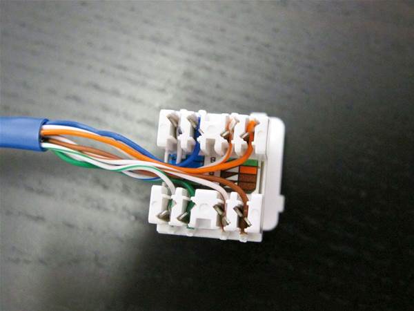

Actually, this is where things are more likely to go off the rails. Category cable is all about twisted pair characteristics, and if you'll allow me a little liberty for inaccuracy to do a better layman explanation, there are RF components to the issue as well as physical factors:
Category 3 cable, which any monkey should be able to terminate, operates at 16 MHz, handling 10Mbps, and due to the long twist length, it was very common to find people untwisting excessive amounts of cable and just punching it. This continued at least into the Cat5 100Mbps era, and among other things, both 10/100Mbps only used two out of the four pair, which made sloppiness somewhat more forgiving since screwing up a pair still left you operable in many cases.
However, with 1GbE, better signal processing led to the use of all four pairs, AND all four pairs being used simultaneously in both directions. This is most of how we got to 1GbE without a significant increase in bandwidth; Cat5e was only 100MHz-350MHz depending on the era. Crosstalk (RF interference between pairs) and delay skew (difference in transmission times due to differing lengths of the pairs) become significant issues though, and therefore it became necessary for installers to up their games on the quality of field terminations. You had to bring the twist almost all the way up to the terminals, and also make sure that you weren't causing pair lengths to differ, or shortening one conductor of a pair more than another. Messing with this would cause weird problems and failures.
With 10GbE, we have once again boosted MHz to 500 MHz, and moved to a much more complicated encoding strategy that includes 16 discrete signal levels. This means that it is even more sensitive to field termination errors, and you really need a perfectionist grade punch technique followed by a thorough cable test/cerification to get this working reliably.

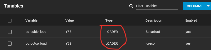

Those are loadable tunables, not sysctl tunables.
I may have misunderstood the question. @Tony-1971 I thought you were asking if the _inc OID was missing because the modules weren't loaded. You can check what CC modules are loaded and which is active:

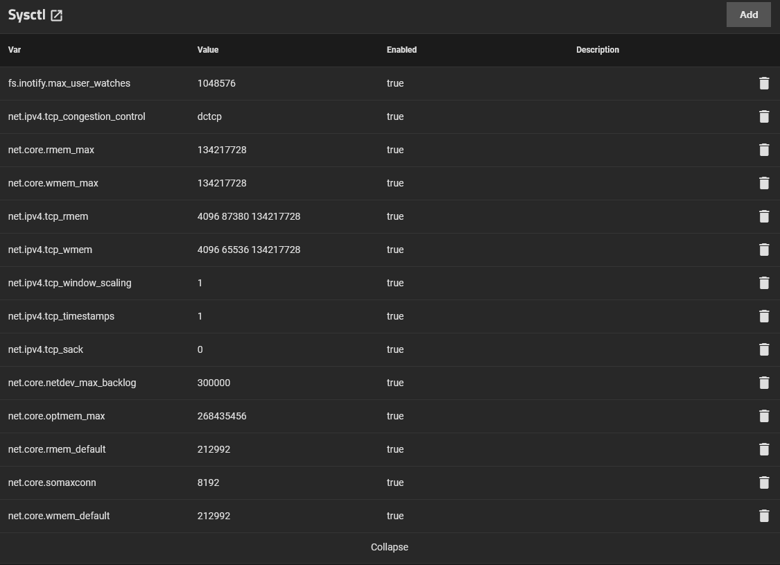

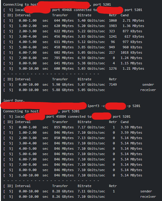

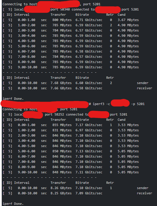

Alright, curious what, if anything, else I can do. I am topping out at 7.1Gbps. Attached are screenshots of my sysctl settings. The systems have identical processors, motherboards, memory, and SFP cards. In each instance the first connection is over my switch, which has plenty of capacity to handle multiple 10Gbps simultaneous throughput. The second in each screenshot is direct from server to server interface. The sysctl options are the same on both, which I have also attached a screenshot of. MTU on the server to server is set to 9000, through the switch is 1500, as nothing else on my network is jumbo packet. I just can't seem to get close to 10Gbps.

Mlovelace
Aug 19, 2014
1,111
The retransmits on that iperf screenshot (retr 7149) shows you've got some issues going on. The column Retr stands for Retransmitted TCP packets and indicates the number of TCP packets that had to be sent again. The lower the value in Retr the better. An optimal value would be 0, meaning that no matter how many TCP packets have been sent, not a single one had to be resent. A value greater than zero indicates packet losses which might arise from network congestion (too much traffic) or corruption, perhaps hardware issues.
Yep, that's why I went direct interface to interface, the re transmits only happen through the switch. The only other difference is the gbics. One machine has finisar, and one machine has cisco gbics. The fiber cable is only .5 meter, and I have tried swapping it with other .5 meter cables I have. Only other thing I can think is to try cisco to cisco gbic, and finisar to finisar gbic.
