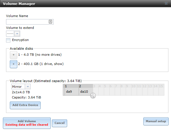

Jimmy Tran
Dec 27, 2015
33
It is theoretically possible, but hardly you want 6x redundancy for your data. :)
So maybe I'm saying it wrong. So what I did was go to the volume manager, and in the volume layout I went 3 across for a mirror, then I dragged the slider down one row to go 3 across and 2 down. Is a vdev with a 6 disk mirror or a vdem with a 3 disk mirror? Please help me correct my terminology so I can provide the community with the proper setup :)

mav@
Sep 29, 2011
1,428
There is estimated capacity indicator. The way it shows bigger capacity is right. :) IIRC moving right increases redundancy, while moving down increases number of vdevs.
How do I freely add and remove disks to mirrors? I don't see how to do that from the GUI.
Hmm. I don't see it in the GUI now, but ZFS definitely allows that from command line.
Mlovelace
Aug 19, 2014
1,111
You're correct. Dragging the slider to the right is how many drives in the vDev; dragging the slider down is the number of vDevs in the pool. You specify the redundancy with the drop down menu but freeNAS tries to suggest the redundancy when you move the slider.
It's been scheduled "for the next major release" for a couple of years now. We've been telling people that they have to export the pool, import it with the CLI, do the operations, export it via the CLI and import it in the GUI again.

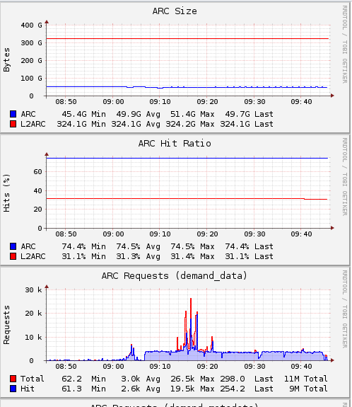

Jimmy Tran
Dec 27, 2015
33
So after 2 weeks this is what my ARC looks like. Any suggestions on how I can tweak this?
