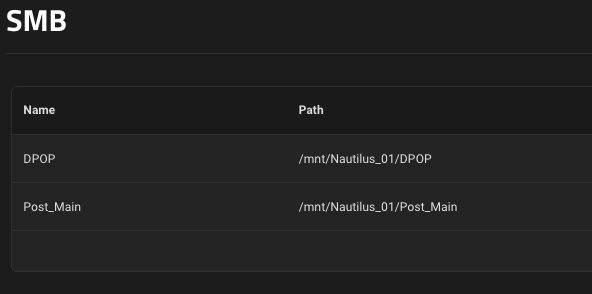

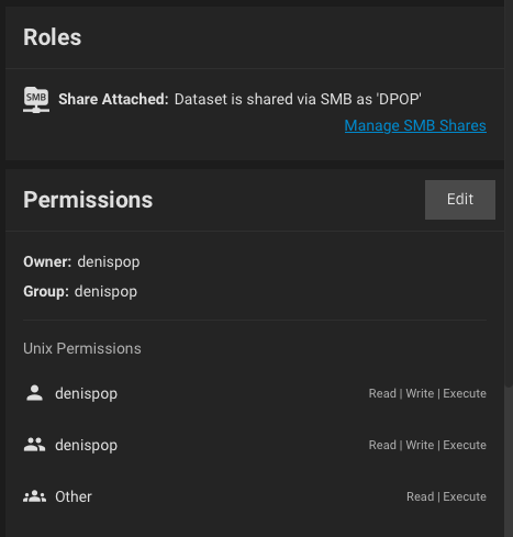

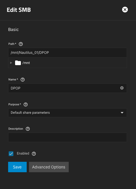

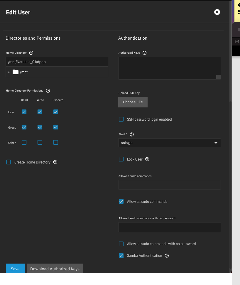

I believe all my permissions and ACL for the user and group are setup correctly?

You need to use the user denispop to mount the shares. You cannot use root. Also, you need to use the share name instead of the path and provide a mountpoint.

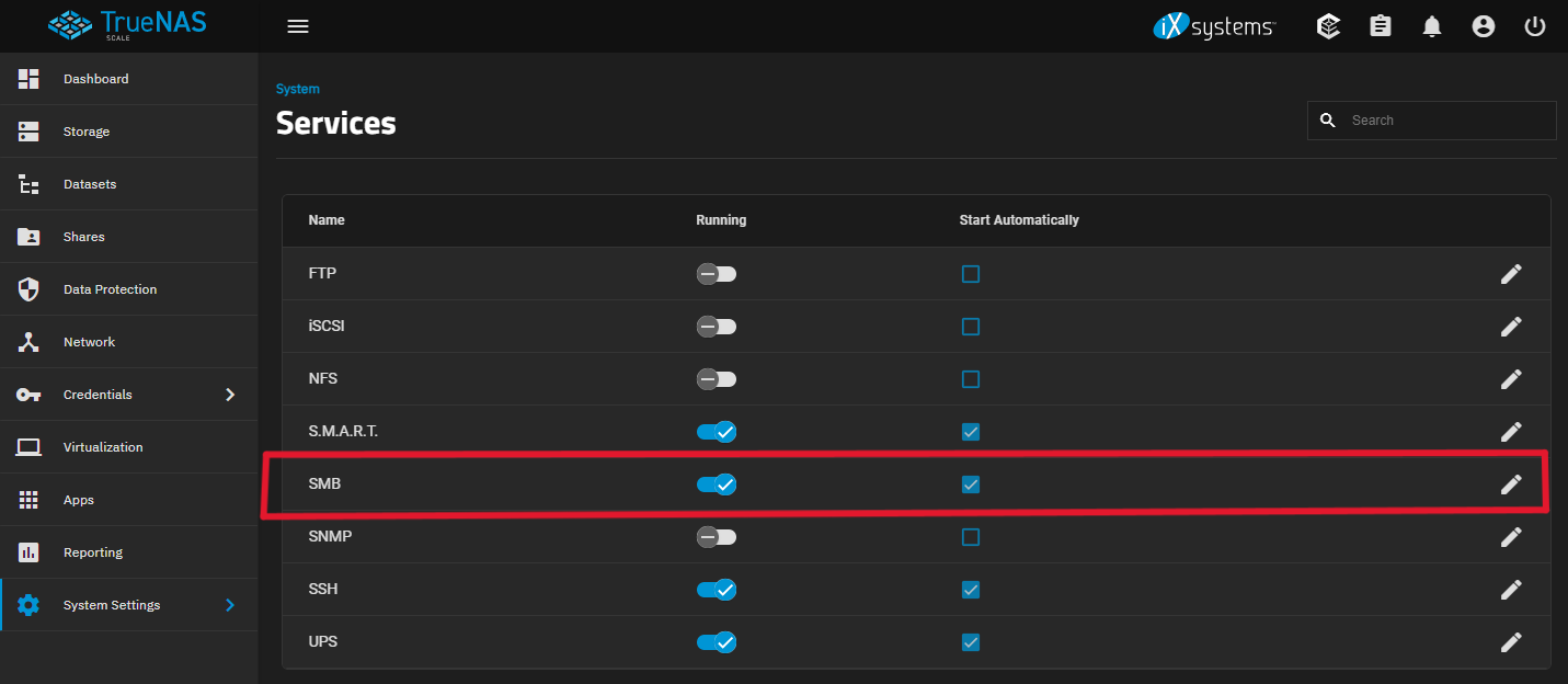

If you go to System Settings > Services. Is the SMB service running?
1) Yep, SMB service is running.
