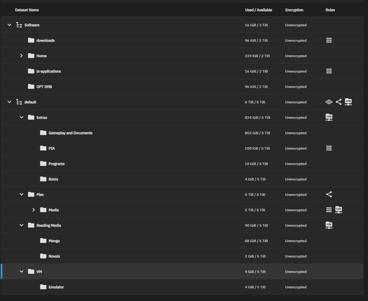

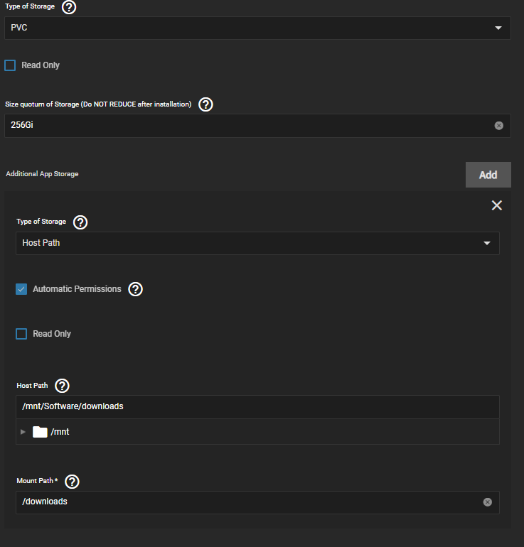

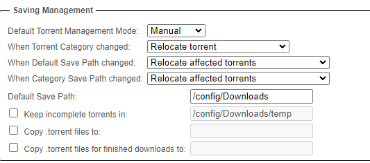

Hello I am fairly new to TrueNAS and had it set up working on angelfish but since the new update to Bluefin I cant seem to locate the file location for my downloads. They would downloads to a a folder I have set as download but not anymore please help I don't know what how to locate them now. Thanks for the help.

Since you mapped mnt/Software/downloads to /downloads inside the container, set "Default Save Path" in the qbittorrent webUI to /downloads. Remember that it's probably case-sensitive so use all lower-case.

Thanks for the reply I did as suggested it worked just had a small hick up with permissions but got it fixed thanks for the help!
