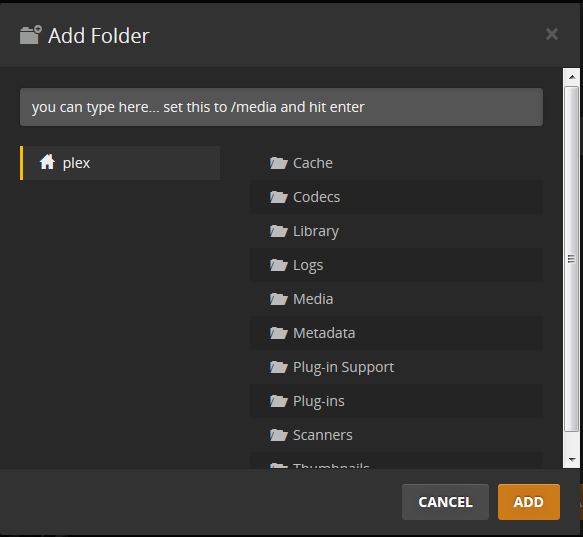

My setup:
FreeNAS-11.0-U2
Plex 1.7.6.4058
My Jail is an old Jail that have persisted thru a lot of FN upgrades. I have also updated the PlexMediaServer plugin manually thru PMS_Updater.sh, so that maybe is one problem also. Somehow Plex does not see the Jail folders, that you see in the console. I can only add new sections in Plex if I know the path. Somehow Plex now sees the "/var/db/plexdata/Plex Media Server" path.
PlexMediaServer console: https://www.dropbox.com/s/ew7iig55mqhn94l/PlexMediaServer console.png?dl=0
PlexMediaServer Jail: https://www.dropbox.com/s/aid3vdkc0ywdaw7/PlexMediaServer Jail.png?dl=0
Plex GUI: https://www.dropbox.com/s/twcnzxlamvyty46/Plex GUI.png?dl=0

In your last screenshot, look at your path.
Your jail storage is mounted at '/media' (destination) from '/mnt/vol1/Video' (source) However your plex path is pointing to '/var/db/plexdata/Plex Media Server/Media' (nowhere in your storage configuration screenshot)
To fix this either change the plex GUI path to '/media' (storage destination), or change your storage destination to '/var/db/plexdata/Plex Media Server/Media'
Alternatively, place a symlink to /media inside the '/var/db/plexdata/Plex Media Server/Media'
that should help.
Personally I set my plext media path to my /media/* folders.
What I would also consider doing is creating a new dataset for your plex library and metadata. This will benefit you when you upgrade your jail.
From other users helping me after my 9.3 -> 11 upgrade, the jails really should be recreated.
Edit to add:
I'm not sure why you can't browse up to /, but my plex is behaving the same as yours. You can, however, type in the correct path and hit enter to manually set it.
that should help.
Edit to add:
As you said the Plex path is wrong and the problem is that you can't browse to the correct path inside of Plex. Don't know why this have happen, wasn't like this in the beginning. I guess I need to recreate the jails, but I'll wait for FN 11.1 as I understand there will be a lot of changes.
