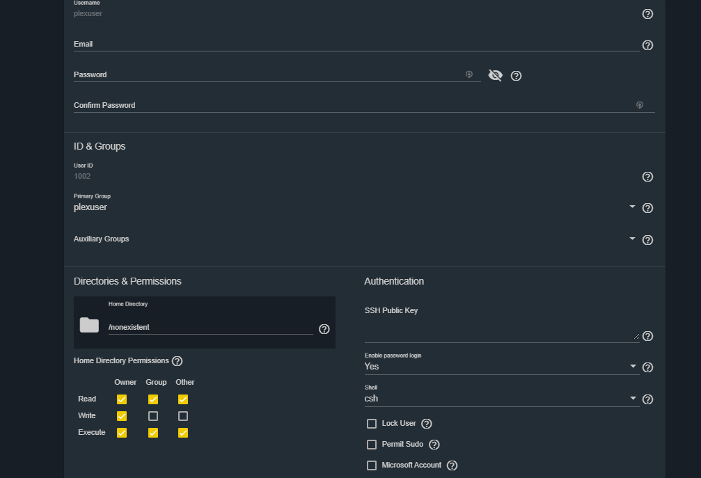

I set up "plexuser" as a User within.
It also has it's own group:

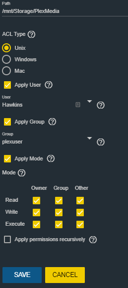

Here are the permissions on my PlexMedia storage pool:
So when I go into Plex and "Scan" for new content, it comes up with nothing. When I go to manually edit/add the new folder in Plex, I click "Manage Library -->Edit -->Add Folders --> Browse for Media Folder --> and I see this:
Note that the "New Test Folder for Demo" I set up for demo purposes is not read initially by Plex (it's "grayed" out). Therefore any content within is not read by Plex.
This is easily resolved by going into the Plexmedia Pool that I set up (two pictures above), clicking "Apply Permissions Recursively", and "Save". Then it works like it should.
So my question to you all? How do I get the New sub-folders to automatically have the same permissions as the "parent folders". Note that I still have full access from my PC to the entire PlexMedia directory (user "Hawkins") without having to change the permissions. I'd rather not have to go in and save new permissions every time I add something. At this point, Plex Live TV DVR is working with whatever I did and the "Scans" work too after I do the step to apply permissions again.

Add a user/group to FreeNAS named plex in the same way you already have for plexuser, and remove the plexuser account, ill explain why. By default plex runs as the user/group plex, unless you change it. FreeNAS knows about the user plexuser, but plex does not. So if you make FreeNAS aware of the user/group plex and add the group "plex" as either the main or an auxillary to your user Hawkins. Then finally chown recursively the root of your MEDIA directory in the same way you have done above to the user/group Hawkins : plex you can likely be rid of this.

So very strange i upgraded to 11.3-RC a week or so ago and now when I go to the plugin page I get an error message and the plugins dont load. One other thing I noticed rereading all of this is that across systems the UID and GID for the plex users should match each other on the FreeNAS host and in the plugin (mine are 972 not sure if this is default).

So my suggestion now is to change the GID of the plex group to 972 in the FreeNAS host. Then again set the permissions recursively to the user Hawkins and group plex (GID 972). So, do this at the CLI
pw groupmod plex -g 972
pw groupmod plex -m Hawkins (makes sure user Hawkins is member of plex group 972)
Dont forget to recursively set permissions again to Hawkins : plex on your media.
