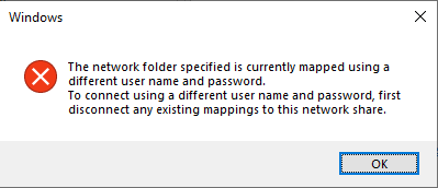

When I try to set up the data sets and shares as described above and try to map them from a windows machine, one succeeds and the second I get this error:

Ahh, there is a limitation that from an individual PC you can only map to one server as a single user - you cannot use two different users at any one time
Doh, I should've picked up on that. In that case, what I described in the post after that is what I'd like to accomplish.
