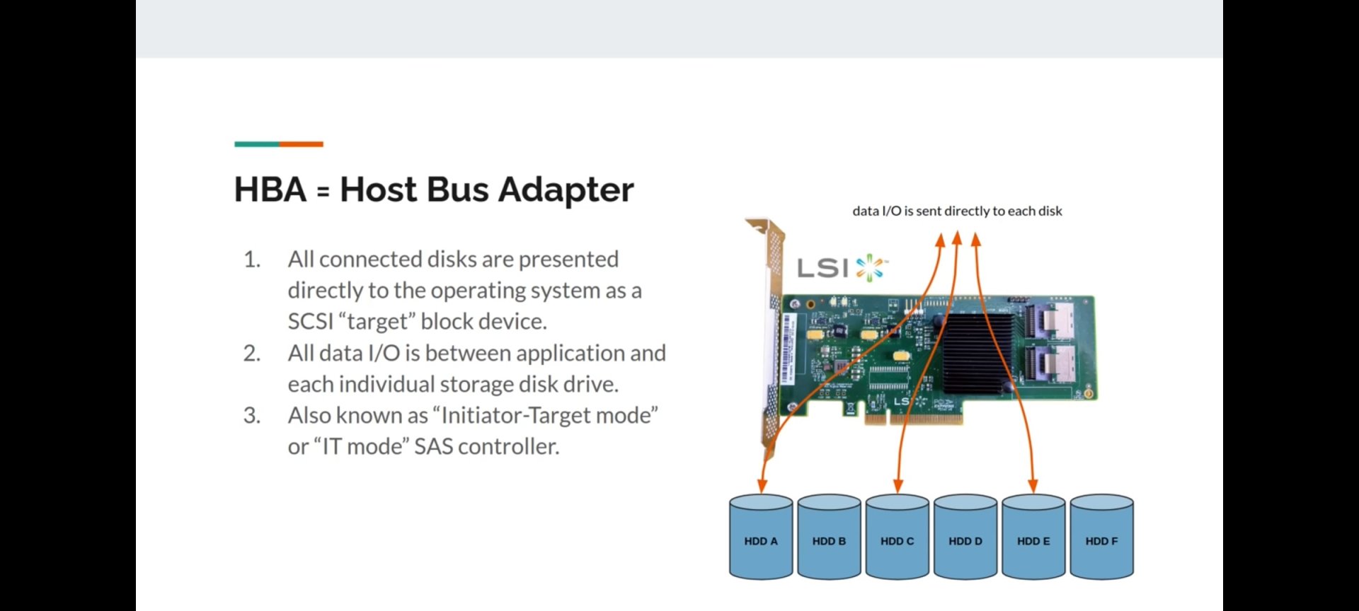

How do I know if I have a HBA, what is an HBA, what is IT mode, and you mean hardware passthrough?
Again, Im very new to this so, that was pretty foreign to me. Haha. Thanks.
MEpke
Mar 20, 2021
13
Slowly learning a bit. I still dont understand 100%...lol looking for one anyway.
MEpke
Mar 20, 2021
13
After researching, it seems I need to find a compatible HBA that works with the R710. At quick glances, maybe the H200 or H310, then I have to verify cables go to the backplane correctly. Right?
