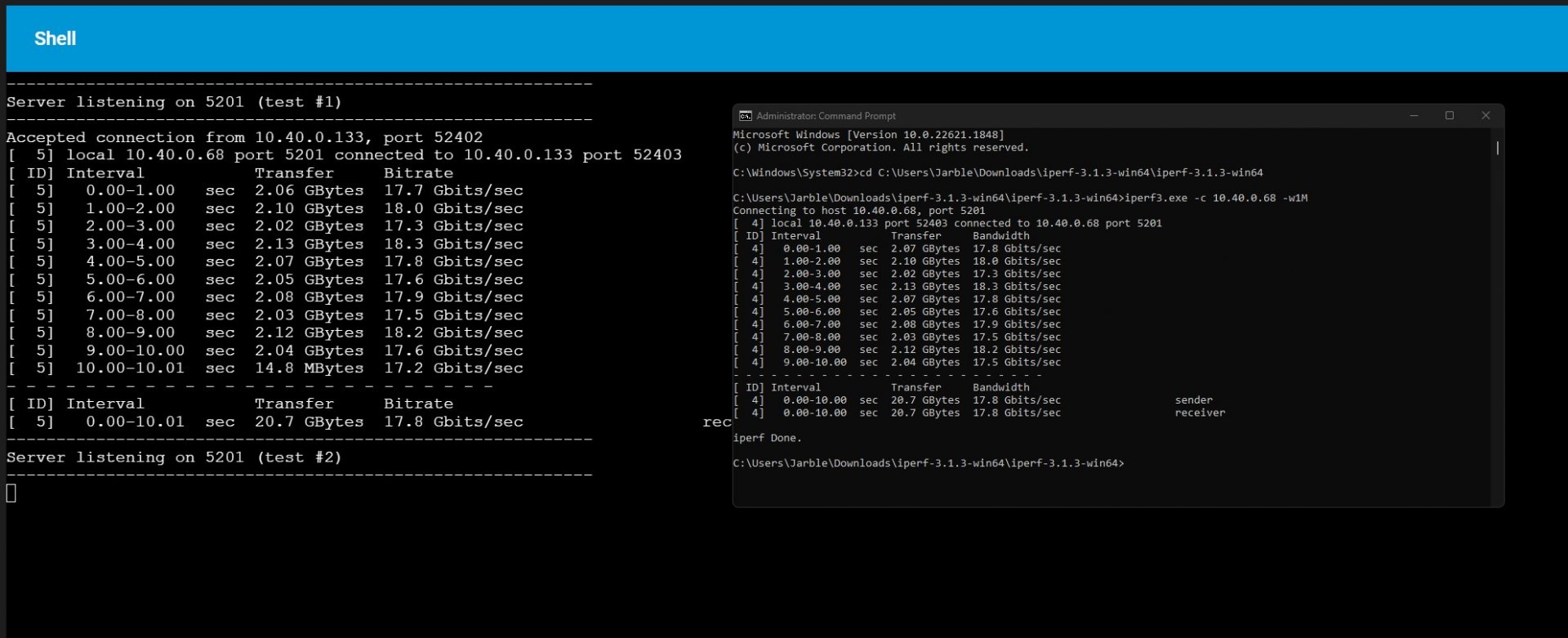

Can you post your iperf3 results in full?

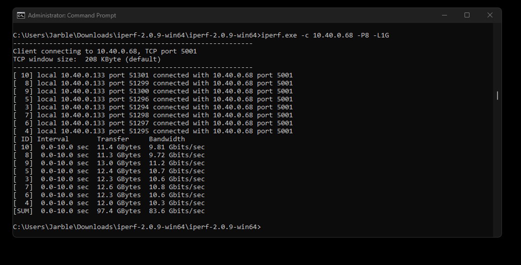

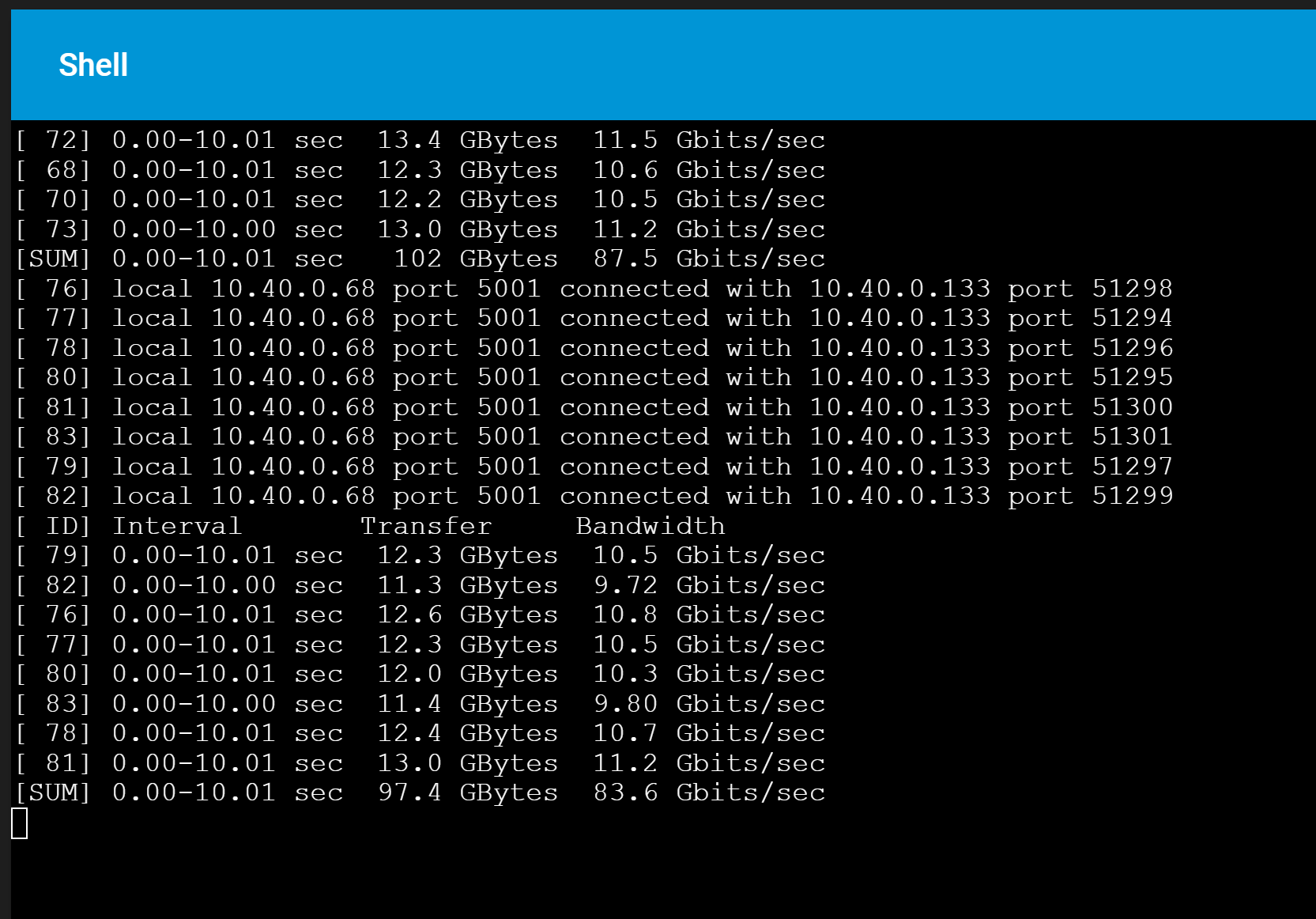

I get the best results with iperf2 so here is client and server. I can also run a iperf3 if needed I just dont know the best commands on it.

What is the client OS and what are the specific tests you are performing on Client to measure throughput?
FYI.. we typically run 10 clients to test a 100Gbe NAS.

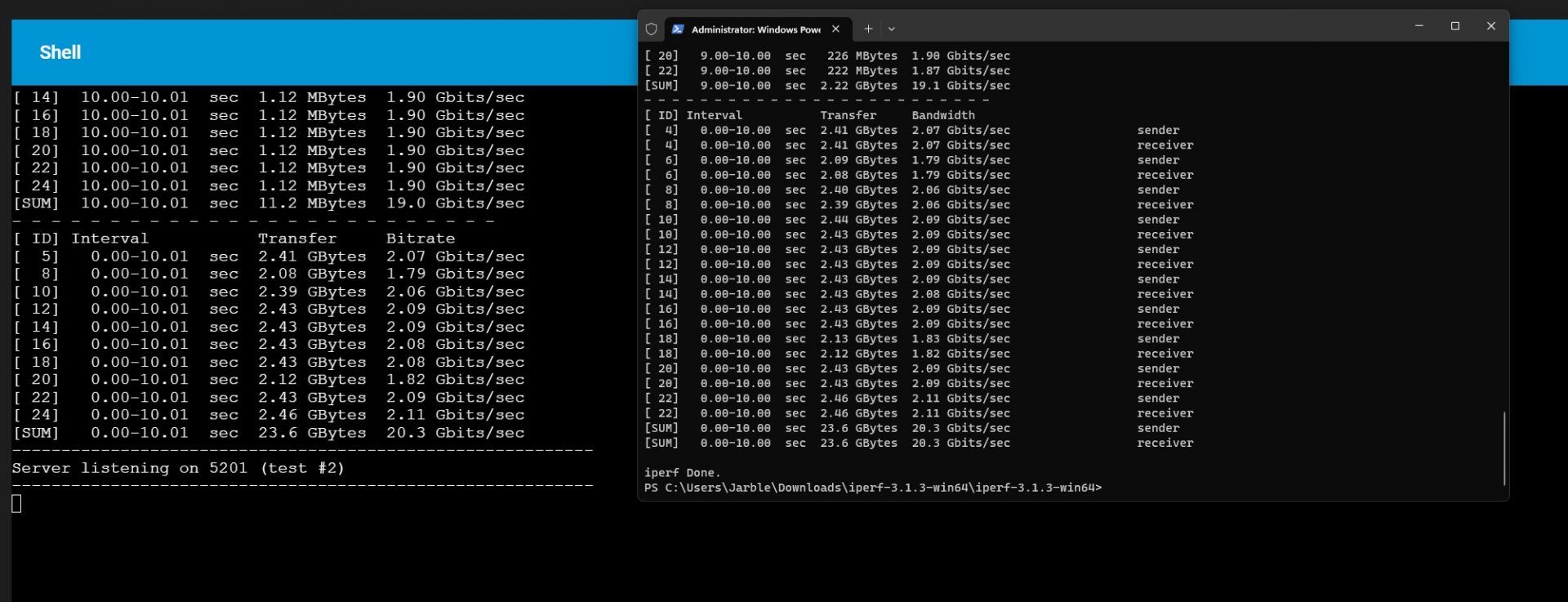

When we are talking about speeds THIS high, your single stream performance isn't going to be illustrative of your maximum performance with multiple clients. To set expectations here, this also likely translates to being unable to saturate a 100 Gigabit link from a single client in terms of file sharing, block devices, or whatever you are trying to do, even if the backing pool can.
You should run your iperf3 client with parameters to test multiple streams. This documentation will confirm this. https://fasterdata.es.net/performance-testing/network-troubleshooting-tools/iperf/multi-stream-iperf3/#:~:text=To run multiple iperf3 processes for a testing,iperf3 -c hostname -T s3 -p 5103 &;
For example, my production homelab SCALE box has a single 100 Gigabit Mellanox ConnectX4, plugged into a 40 gigabit port with a 40 gigabit DAC. I have an Epyc 7282 CPU so I'm not far off from you. My workstation has a EPYC 73F2 with a 25 Gigabit Mellanox ConnectX4 card, but I am using 10 Gigabit optics. It's also going through another switch, FWIW, so a bit of extra latency.
With only a single stream, I get:

But if I set the streams to 10, as @morganL suggests for 10 concurrent clients, I get closer to 10Gbit/sec
C:\Users\nickf.FUSCO\Downloads\iperf-3.1.3-win64 (1)\iperf-3.1.3-win64>iperf3 -c prod.fusco.me -P 10
Thanks for the reply. The client is running windows 11pro and for test I have done both simple file copies and crystaldiskmark with both returning the same odd 10 down 20 up scenario.
jarble
Apr 22, 2023
17

Using iperf3 default single stream I am getting right at the 20Gbits/s
Edit: After some thought I decided to test the other direction with the truenas as the client and the windows machine as the server and low and behold I cant break 10Gbits/s in iperf or iperf3.
NickF
Jun 12, 2014
763
sure, but the point I was making was that you NEED to leverage parallel operations to actually utilize your link. What are your results with -P 10 like in my example above?
Right at 20Gbit/s

Not sure if I am capturing what you are looking for but I made a quick snip of htop running while the iperf3 is connected
  • Recording 2023-06-29 223736.mp4
NickF
Jun 12, 2014
763
If you'll notice, iPerf3 is hitting over 54% of your CPU usage during that test.
k: %CPU -- CPU usage
The task's share of the elapsed CPU time since the last screen

Have you looked at the resource on 10G and higher networking from @jgreco ? If wasn't able to get my systems to get full performance on a 40G network until I did some the the suggested tuning in that resource. Afterwards I was able to get in excess of 39Gb using iperf3.
jarble
Apr 22, 2023
17
I am trying to follow the guide I found that they wrote here https://www.truenas.com/community/r...ng-to-maximize-your-10g-25g-40g-networks.207/ but I am struggling with where to add the flags after setting the algrithum to cubic.
indy
Dec 28, 2013
287
Try
iperf3 -c <your-ip>
iperf3 -c <your-ip> -P 8
iperf3 -c <your-ip> -R
iperf3 -c <your-ip> -R -P 8
iperf3 will show if packets are dropped, I am not sure iperf2 does.
jarble
Apr 22, 2023
17
Try
iperf3 -c <your-ip>
C:\Users\Jarble\Downloads\iperf-3.1.3-win64\iperf-3.1.3-win64>iperf3.exe -c 10.40.0.68 -P8 -R
Connecting to host 10.40.0.68, port 5201

[ ID] Interval           Transfer     Bandwidth       Retr
[  4]   0.00-10.00  sec  1.41 GBytes  1.21 Gbits/sec    0             sender
[  4]   0.00-10.00  sec  1.41 GBytes  1.21 Gbits/sec                  receiver
[  6]   0.00-10.00  sec  1.43 GBytes  1.23 Gbits/sec    0             sender
[  6]   0.00-10.00  sec  1.43 GBytes  1.23 Gbits/sec                  receiver
[  8]   0.00-10.00  sec  1.43 GBytes  1.23 Gbits/sec    0             sender
[  8]   0.00-10.00  sec  1.43 GBytes  1.23 Gbits/sec                  receiver
[ 10]   0.00-10.00  sec  1.43 GBytes  1.23 Gbits/sec    0             sender
[ 10]   0.00-10.00  sec  1.43 GBytes  1.23 Gbits/sec                  receiver
[ 12]   0.00-10.00  sec  1.43 GBytes  1.23 Gbits/sec    0             sender
[ 12]   0.00-10.00  sec  1.43 GBytes  1.23 Gbits/sec                  receiver
[ 14]   0.00-10.00  sec  1.41 GBytes  1.21 Gbits/sec    0             sender
[ 14]   0.00-10.00  sec  1.41 GBytes  1.21 Gbits/sec                  receiver
[ 16]   0.00-10.00  sec  1.43 GBytes  1.23 Gbits/sec    0             sender
[ 16]   0.00-10.00  sec  1.43 GBytes  1.23 Gbits/sec                  receiver
[ 18]   0.00-10.00  sec  1.43 GBytes  1.23 Gbits/sec    0             sender
[ 18]   0.00-10.00  sec  1.43 GBytes  1.23 Gbits/sec                  receiver
[SUM]   0.00-10.00  sec  11.4 GBytes  9.79 Gbits/sec    0             sender
[SUM]   0.00-10.00  sec  11.4 GBytes  9.79 Gbits/sec                  receiver
iperf Done.
