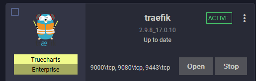

I've installed this and am getting 404 page not found when I go to my server:9000 or server:9080
There is an open button on the application tile but that doesn't do anything.
I installed Traefik form Truecharts

9,703
Does that point at port 9000?
also, did you move the TrueNAS ports away from 443/80? (and are you sure the app is running and not just re-deploying, crashing and starting again?)
It appears to be running
and I'm accessing my server now on port 81
In my browser
9,703
Try it like this:
Also, you should have changed the ports to be 443 and 80, not 9443 and 9080 (otherwise, you don't need to move the TrueNAS GUI).
I just did the (painful and IMHO completely unnecessary) process to upgrade that app yet again and I see where you are. The current/latest version has broken the Open button.
