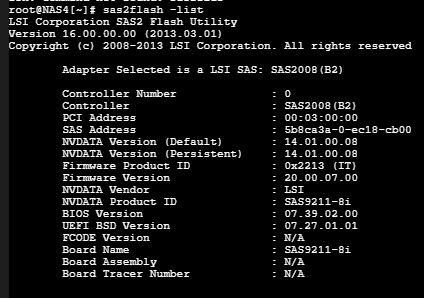

sas2flash -list will get you the adapter info and show IT or IR mode:
Here's the output of the command once it's ran:

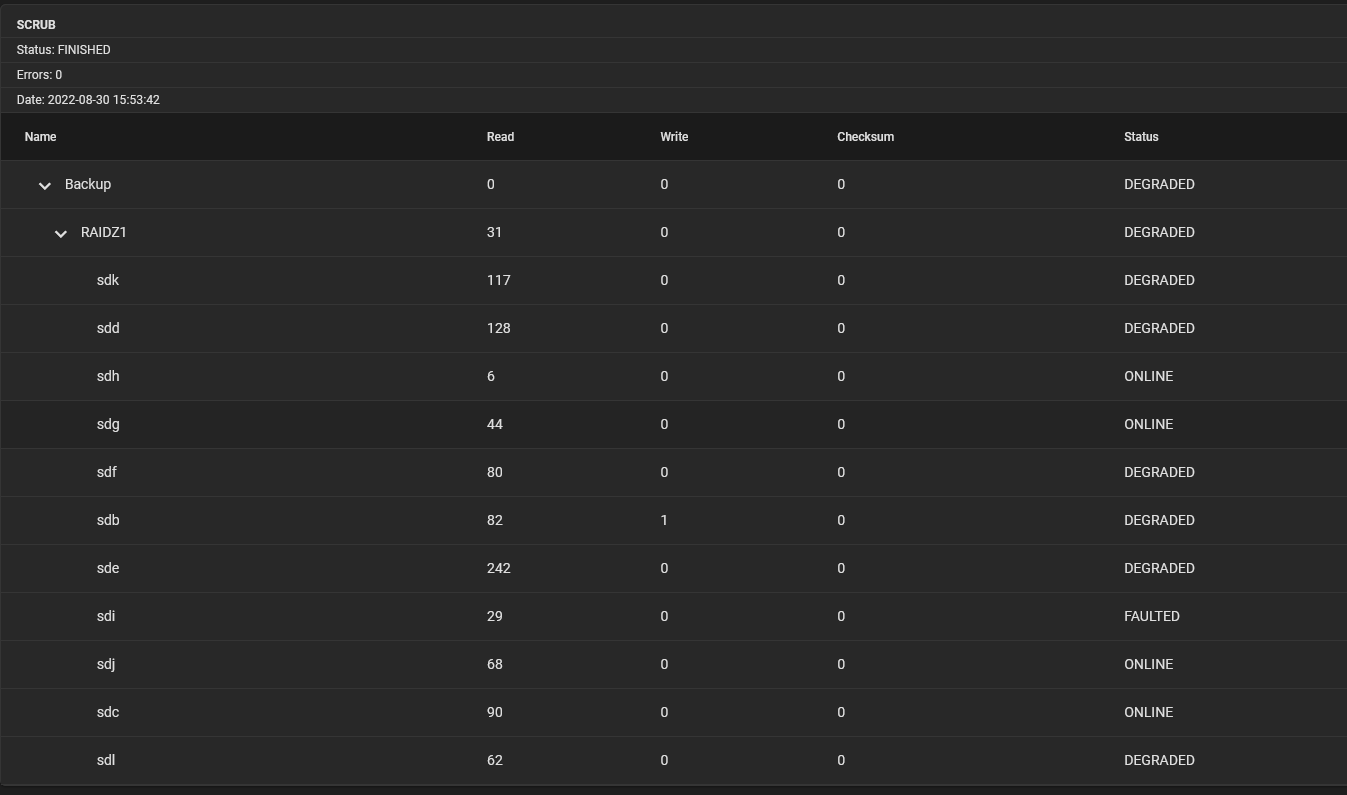

Here's the drive after the scrub completed:
Should I replace the faulted drive? Or still, be more concerned about the entire pool/hardware malfunctioning?
Firmware Product ID : 0x2213 (IT)
Firmware Version : 20.00.07.00
That appears to be the correct mode ("IT") and the latest version (that I could find).
So, you are good there.
Did you look into the temp for the HBA as suggested? Is it crammed in with little space? Or, does that card look well ventilated?
In my opinion it depends on the drives. If these are really a collection of old drives, there may actually be that many bad ones... In that case, I think it would be pretty unreliable, especially on Z1, to try to use them. Replacing the faulted drive would just be polishing a turd. And with turd-based polish if its with another old drive!
I'm also not able to offline the bad drive it seems... It just spins and then does nothing when I try to offline the failed drive.
When it shows as FAULTED it is typically already ready to be replaced (doesn't need to be offlined): https://www.truenas.com/community/threads/drive-faulted-cant-offline-it-to-replace-it.91297/
I'm not certain about your other questions. So, hopefully someone else can chime in to cover those. I don't think that moving the files via CLI should have created an issue. But, not 100% on that.
The card is well-ventilated. It is the only card back there and seems to get good airflow from the fans.

This looks like you are using 4 different types of hard drives? What is the context behind that?
It was what we had available. I'm beginning to realize that this was probably incorrect to do.
I don't want to make assumptions. The asker might have something else in mind. But, they may just be asking for more details about all of your hardware. RAM, CPU, MB, Drives, Boot device, etc.
I see, I assumed there was some way to output system configuration within TrueNAS
"Old_age"? Are these old/used drives? If so, what is their specific history?
I'm honestly not sure either. I'm beginning to realize that relying on Amazon to sell you "new" drives is highly unreliable. Will probably look at going through an alternative re-seller at this point. Any good recommendations?
I think the plan now is to replace all of the drives and rebuild the pool. I believe I've got all of the necessary data off of the drives that is needed.
This is good to know, thanks!

I'll also likely be scrapping the drives and going with "new" WD RED drives.
That's a good choice. Just make sure that you get the CMR model. Not the SMR ones.
Unfortunately, I think Amazon is probably the best choice. I've never received old hardware from them before. Not doubting you. I know that kind of thing happens there. But, it must be rare.
I had a terrible experience ordering a batch of Red drives from Newegg one time. They delivered to the wrong house. When I tried to correct it they actually asked me to file a police report to prove that they messed up! Took over a month to resolve. So, I will never use Newegg again.
I recommend going with fewer but larger capacity drives. In RaidZ2. Maybe 8 or 6 x 4TB depending on your needs. This way you can fit them all on one HBA. Also, with fewer drives, if you ever wanted to upgrade the sizes its a bit easier (offline and resilver with larger drive replacements one at a time).
Also, order enough to have 2 spares ready. And register all of the drives with WD. If any of them goes out within warranty you just send it in and get a new one. I've had them replace a couple over time.
Demonlinx
Apr 11, 2022
53
I'll look at making sure the drives are CMR.
Yikes! That doesn't sound good at all. Hopefully Amazon will be better with the next shipment of drives we purchase.
Are there any 12i card variants? I know that when I was looking last there was nothing like that.. Is it only recommended to form pools with drives that are on the HBA?
Already have many spare drives available.
