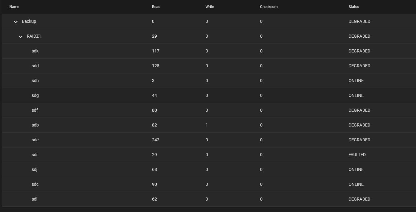

I noticed that my storage pool was unhealthy. So I decided to do a scrub. During the scrub it shows various drives as degraded and one of the drives as faulted. I'm not sure what to do at this point..
Any help would be greatly appreciated!!

Yes, I do. Should I wait for the scrub to finish before replacing the faulted drive? I also did a massive write of about 4TB to the drives. Would this cause issues like this? This is the first time we've really used this system, and I'm concerned about the stability.

This is also not the first time I've seen behavior like this with this system. I had thought that it was initially issues with the SFF cables between the HBA card and the backplane for the HDDs. I'm not really sure how further to diagnose what's going on. I'm running this on a DL180 G6.

Based on another case: https://www.truenas.com/community/threads/disks-statuses-faulted-and-degraded.90334/
This seems pretty odd to get errors across that many drives all at once. Maybe a controller is going out? Did you make any HW changes recently? Disrupt cables, etc.?
No, nothing has changed in the system hardware. The server is secondhand, and the HBA is just off Amazon. The SFF cables were replaced with new cables.

I would wait for the scrub to finish to better understand entire situation.

You say this is the first time you used it? How long has it been on-line? If this happened right away, it suggests something wrong above the drives, imo.
(Side note: with that number of drives in the pool I would recommend Z2.)
Are you able to access the data where it is now and is it backed up or non-critical?

They are 2TB Hitachi drives. We're thinking about running Z2 but figured a single drive failure was not the end of the world and 2 drive failures happening was highly unlikely; alas here we are.
Data is backed up offsite, however, the 4TB of data that was moved was the offload of an additional server and get that server ready for an upgrade to TrueNAS as well. So the data is somewhat critical, but ultimately could be recovered.

Ok. For now I would report back here with final results when the scrub is finished. I have a lot of practical experience. But, I think you may need much more technical know-how to figure this one out.
I've never seen a bunch of drives show problems all at once like that. So, it feels like something systemic rather than drive failures. I've had to replace a couple single drives from time to time and it has always just been one with the errors.
Could there be a heat issue? Checked the drive temps during the scrub?

The HBA you have covers 8 drives. But you are showing 11 in the pool.
Is there a pattern to which ones show degraded vs online? In other words, are the ones not on the HBA showing online?

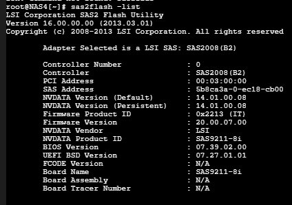

That should be ok. I have the LSI 9211 and never had trouble with it. But, did you flash it for IT passthrough mode?

I did not flash either of them for IT passthrough mode. Could this be the cause of the issue? If so, how do I go about flashing them?

How can I see which drives are connected to the HBA vs which are not? I don't see any correlation to the drives having issues being on the HBA vs not...

Comments that I saw on the purchase page indicated that it was already flashed for IT passthrough mode. Is there any way for me to tell this from the CLI?

From this thread it looks like your model should already be in that mode: https://www.truenas.com/community/threads/flashing-it-mode-9207.69510/
But, I would double-check that. Make sure its in that mode and using the latest firmware.
I'm not certain what the consequences are of not being in that mode. But, it's a possible cause, imo.

sas2flash -list will get you the adapter info and show IT or IR mode:

DL180 G6 has expander on the backplane
If its 12х3.5" it should be working OK with SAS2008 IT. I have 4 of these serevers working for years already solid.
Can use
sas2ircu 0 display
to show which drive reside in which bay (0 is controller number - you'll figure it out)
and
sas2ircu locate
to light a led on a drive caddy of your choice
also would be helpful if you posted entire system config, and output of
smartctl -a /dev/sd*
for every drive thats faulty
mpsutil show all
too
