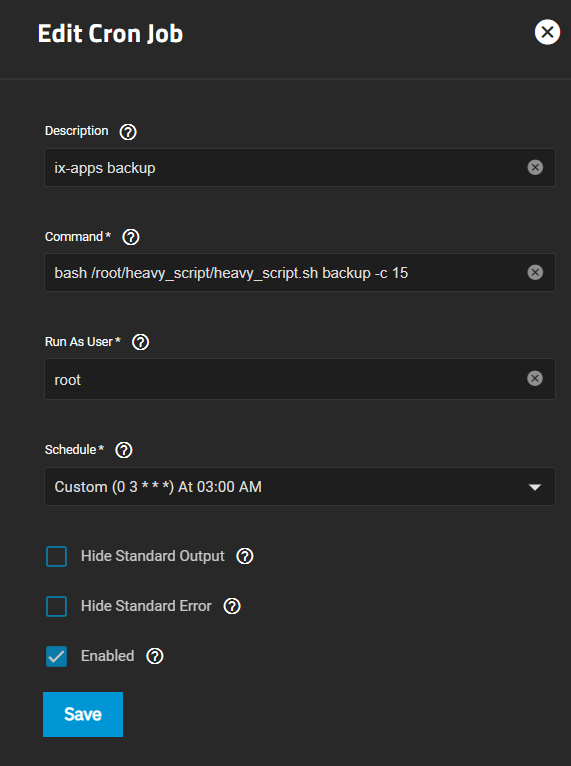

I'm on TrueNAS-SCALE-23.10.0.1, but this issue has been with me for a while. I've set up a few cron jobs (in system settings/advanced), and while they run without problems when executed manually (triangle icon), they never run automatically.
One of my jobs runs "heavyscript backup" at 3 am (see attached image). After a manual run, I'm sent an e-mail with the output. It's all good as long as I run it manually, however, nothing happens at 3 am - no email, no backup made. On the other hand, replication tasks run on time and reports are sent, and I also get emails about other outstanding issues, so it's not an issue with the notification system or all cron jobs. Nextcloud cron jobs (configured by the Truecharts app) also run regularly (as far as they're present in journalctl), but my own cron jobs don't. And this isn't something that worked until one point and then broke, this cron job has never run by itself as far as I can tell.
I'd appreciate any advice on how to dig deeper to understand and fix the issue.

Thank you for the suggestion, but this was not the issue. The /etc/cron.d/middlewared file includes /usr/bin in its path so "bash" is just as good as "/usr/bin/bash".
However, I was able to identify the cause. One of my cron jobs had the minute defined as 1/10 instead of */10 and this caused the following error (from journalctl -xe):
Dec 01 22:36:01 MainNAS cron[3313]: (*system*middlewared) RELOAD (/etc/cron.d/middlewared)
Dec 01 22:36:01 MainNAS cron[3313]: Error: bad minute; while reading /etc/cron.d/middlewared
Dec 01 22:36:01 MainNAS cron[3313]: (*system*middlewared) ERROR (Syntax error, this crontab file will be ignored)
The offending cron job:
1/10 * * * * root PATH="/bin:/sbin:/usr/bin:/usr/sbin:/usr/local/bin:/usr/local/sbin:/root/bin" midclt call cronjob.run 1 true > /dev/null 2> /dev/null
I've changed it to */10 and now it runs as expected.
However, while I'm not certain it's correct cron syntax or not, 1/10 is recognised as correct by the UI! It's telling me that 1/10 means every 10 minutes starting from 1. So, even though it was a mistake on my part, the UI didn't complain about it. I'm wondering if it's an oversight.
