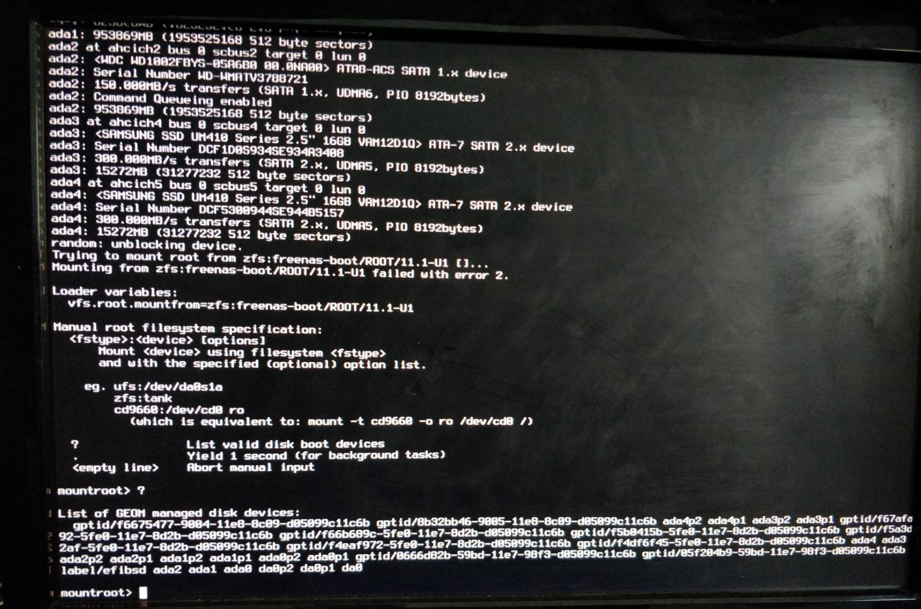

- I happened to have another USB (identical to the previous) that had a mirrored copy of 11.1-U1 on it and I am able to boot to it but during the boot process it stops at a mountroot prompt. (see image) I'm assuming that this is because I was running 11.1-U5 before this all started.

Question 1: Is there any way for me to get past this prompt and continue the boot so I can recover and properly transfer the boot media to these SSD drives? I've tried several different commands without any luck. My ZFS is setup on three identical Western Digital drives (ada0,ada1,ada2) The two identical Samsung 16GB SSDs that I would like to be my boot drives are ada3 and ada4 respectively. da0 is the 16GB usb thumb drive which has 11.1-U1 on it. "CNAS" is the name of my ZFS pool. Alternately is there a way to upgrade the USB flash to 11.1-U5 without being able to boot it?

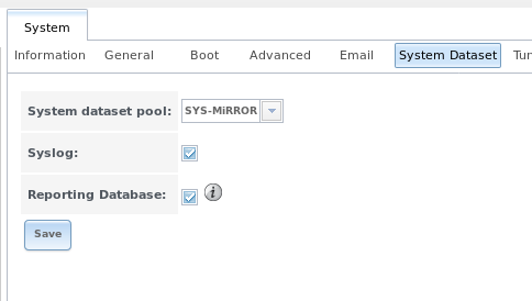

Did you point the system data set to your pool (like below)?
If so, there should be saved copies of the config stored in there someplace. I haven't had to do that yet, but I know there are other in the forum that do. If not, perhaps we could mount one of your old USB boot media drives and extract the config from there. You'll have to do that from FreeNAS or something else that understands ZFS. You won't be able to do that from a workstation.
