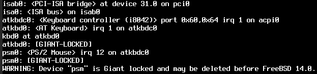

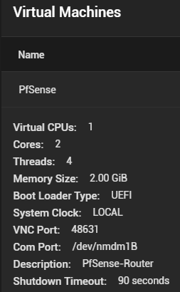

I have the very same issue.

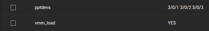

Setup is:
ProLiant DL380P Gen 8.1 - 4 Port Broadcomm NIC -> TrueNAS BHyve - Passthrough 3 out of 4 ports (3/0/1 3/0/2 3/0/3) -> PfSense

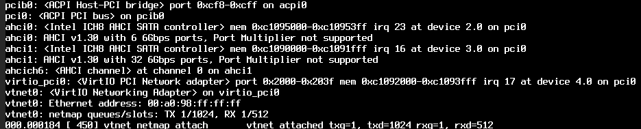

And in PfSense:
Can someone at least rule out this being a TrueNAS problem?

I should also point out that I have a virtual NIC from a TrueNAS bridge with no NICs attached, that is the NIC that is showing up in boot (vtnet0).
