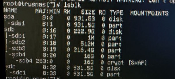

Just for FYI, my disks capacity are as follows:
2x of 1TB and 1x of 2TB.
i tried to plug in back the faulty disk (1TB) alone without the other 2 disks and surprisingly can read without problem.
Then i insert the other disk one at a time, first is the other 1TB which is working fine both of them are ONLINE.

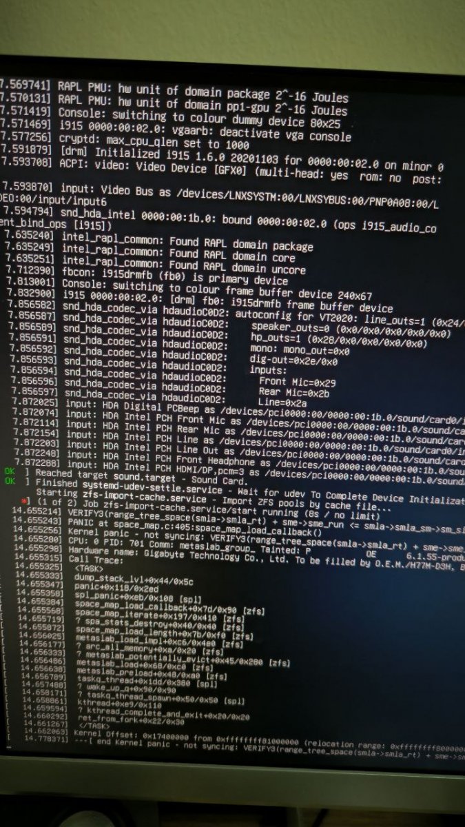

When trying to insert the other disk which is the 2TB, i got stuck at boot error:
This error happens only when inserting the 2TB disk.

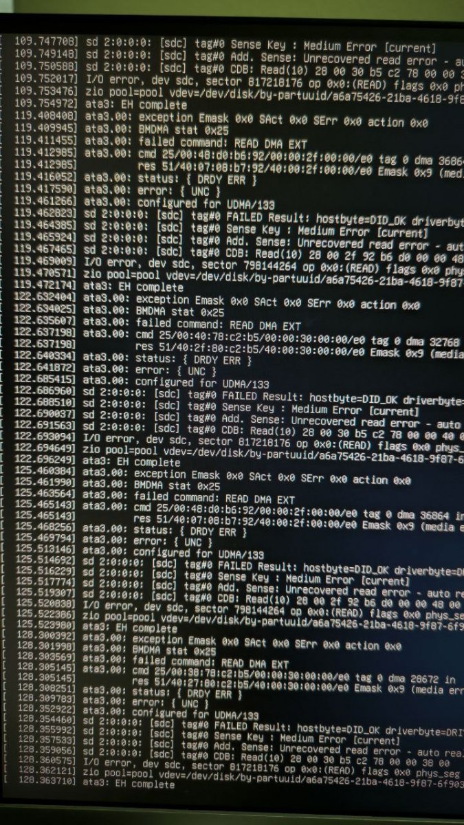

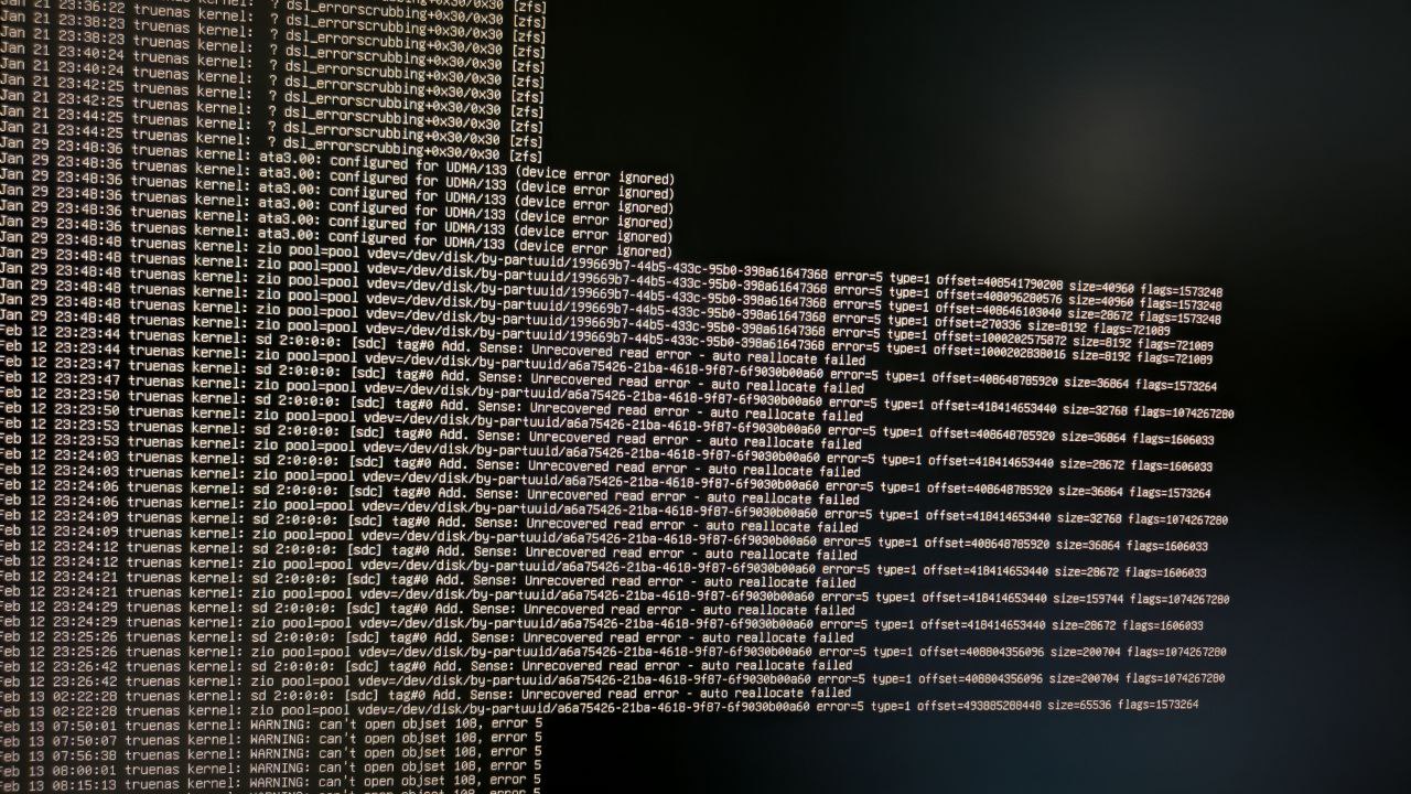

I tried to swapping drives and use only 2 disks 2 at a time and tried to force import using
zpool import -fF pool
It's trying to import but failed in the end after a reboot, probably detecting a lot of errors.
grep "error" /var/log/messages
I wonder, if there is a way to skip blocks that has errors on disk.
