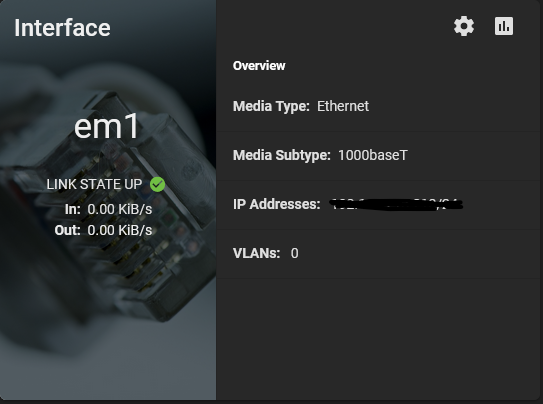

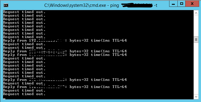

1- Nic Card detect on TrueNAS (pic1)
2- I set Static IP Address on card but em0 not up and only em1 up
3- when i ping ip, reply ping is unstable (pic2)

Please DON'T try to compile a driver; it's already built in.
You likely have a cable issue or a hardware problem with the NIC. There's still a decent chance you have a counterfeit card.
