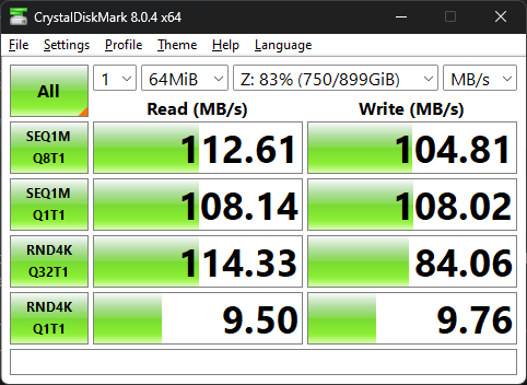

Your 1Gbps network card is likely to be the speed bottleneck - a local SATA SSD is capable of around 550MB/s of reads, and your network will likely limit you to ~110MB/s of reads, or about one-fifth of the load times of a SATA SSD. A local NVMe SSD will load in the order of "gigabytes per second" - if you're mostly loading smaller titles, the difference may not be felt, but larger titles or ones that rely heavily on asset streaming may have challenges with this setup.

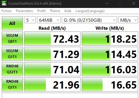

I'd say those speeds are not too bad given your system.
911AS
Jan 8, 2024
10
You mean it could be even worse? J/k. :smile:
Why is writing faster than reading? Shouldn't it be the opposite?
Yup... with a Realtek chipset this is not bad.
With TrueNAS, the RAM is used for cache (read and write).
When writing, you write to the RAM first before it gets written to the disks, so this is very fast. In the test you've done, you probably didn't fill up all the cache so the write operation is fast.
Reading is slower because you also read from the RAM but the first time, the data is not in the RAM but on the disk, so it takes longer to access.

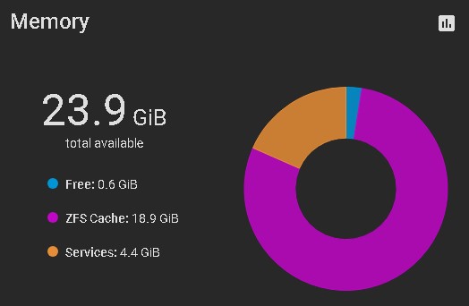

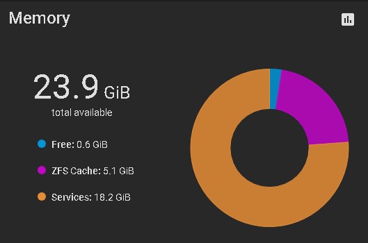

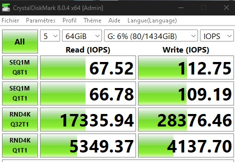

I tried with a 64GiB file size in place of 64MiB. The speed is almost the same. It just much longer to execute. I thought once the memory will filled (see pictures below) that the speed will be affected but it seems is not the case.
The IOPS are also nearly identical.
The ZFS cache as expected for the big file use pretty much all the memory. But why with the smaller file, the server don't free up memory but allocate it to the services?

At that point, I'm not familiar enough with TrueNAS's memory management to explain this behavior... :tongue:
For the 64GB test, are you writing on your NVMe pool or the HDD pool?
If I understand correctly, your pool uses the SSD and the HDD drives, right, so no surprise you don't see differences because in that case the bottleneck is not the drives (but then something else).

The lower-than-gigabit reads are probably a result of the Realtek network card; if I recall, they seem to be notably poorer on the "sending" side than "receiving" which makes sense given their target market of consumer gaming gear.
I happen to have a Nehalem-era Xeon system kicking around - peak read speeds are a fair bit better, writes a little less so, but it's backed by only a couple of "well-aged" SATA-2 HDDs.
All the tests were with the NVme only. Nothing else.

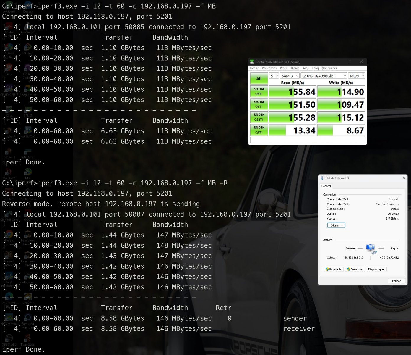

I installed a new 2.5G NIC(Intel i225-v rev-3) on my TrueNAS server, and my PC already had an integrated 2.5G NIC on the MB(Intel i226-v w/ last driver). I also bought an unmanaged 2.5G switch box.
I did some tests and the performance is very bad. I don't know why. I added below a picture of the test result and a picture of my network setup.
The setup is simple. The black cable (cat8, is the shortest i have) connect the switch box to the router (100/1000G). The left yellow cable connect my NAS server and the right yellow my PC (both cables are cat. 6). The switch box indicated the yellow cable has 2.5G speed and the black one 1G speed has expected.
What am I doing wrong?

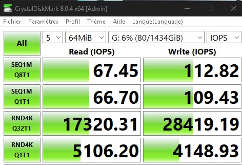

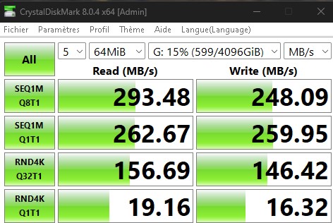

I recently changed my network configuration to finally obtain the performance expected from a 2.5Gb network.
To do this, I changed my ethernet switch with a YuanLey 4x2.5Gb ports and 2x10Gb SFP+ ports, I replaced the 2.5Gb Intel I225-V network card with an Intel X520-DA2 10Gb and I used a cable 6 foot multimode OM3 fiber optic cable with transceivers for Intel.
These changes fixed the performance issues. With Iperf3, I get a speed of 282MB/s in both directions. And with the CrystalDiskMark utility (the drive is a iSCSI share), a notable gain:
Even if is a somewhat expensive learning curve, I am happy with the final result.
ChrisRJ
Oct 23, 2020
1,919
Given your CPU and the overall age, this is really not bad. :smile:
