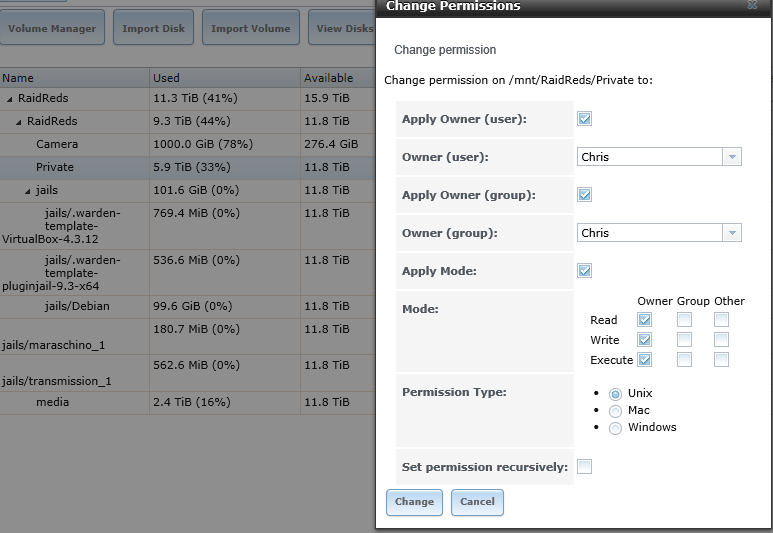

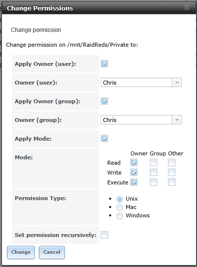

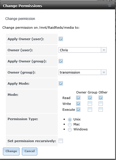

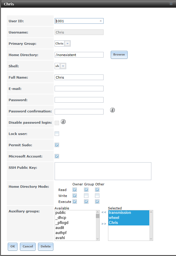

I have a couple users, Chris (me), transmission, house (for my IP cams). I have a share names private that has the owner and group as Chris with only Owner having any access and it's under Unix type. I was able to access it with root (sometimes) for some reason and not Chris. Says invalid password for Chris (trying to access through windows 10). Under Linux when trying to access the cifs server as a whole I get No Route To Host. I am decently new to Linux and pretty new to permissions. What do you guys need from me to help troubleshoot?

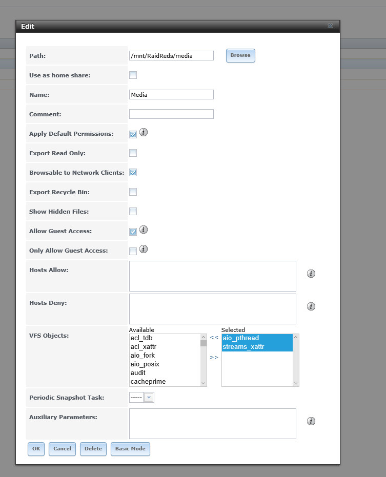

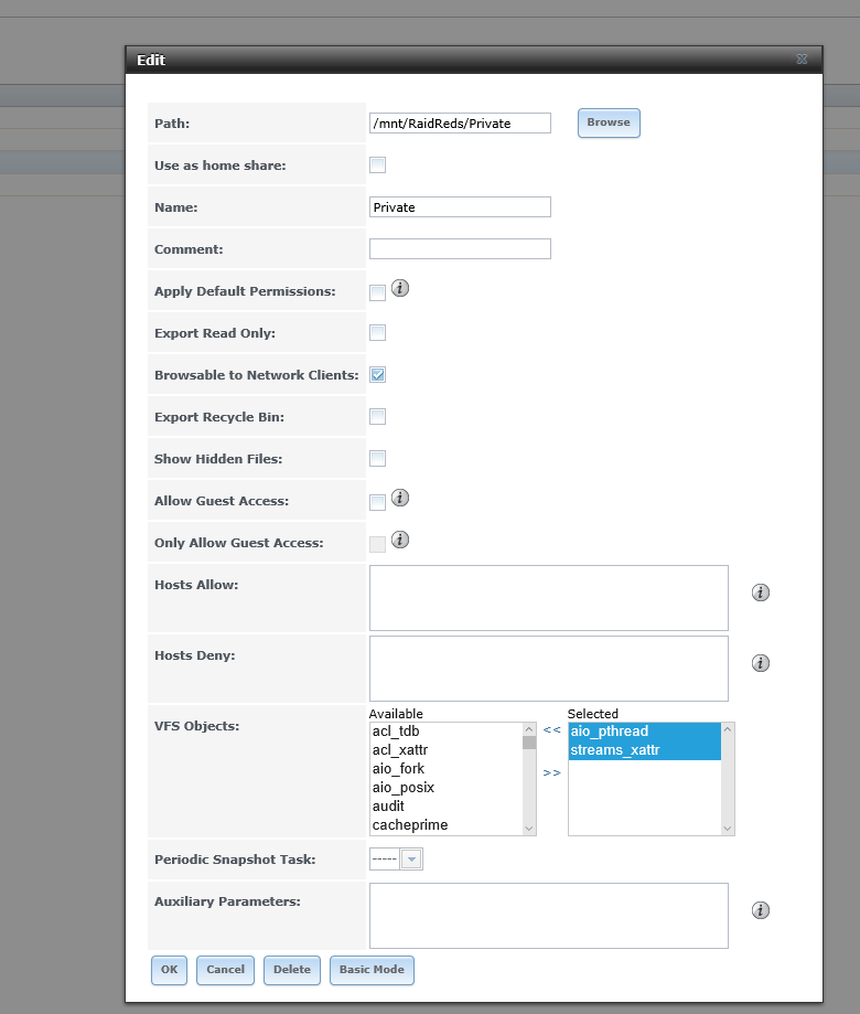

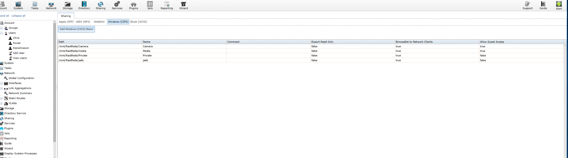

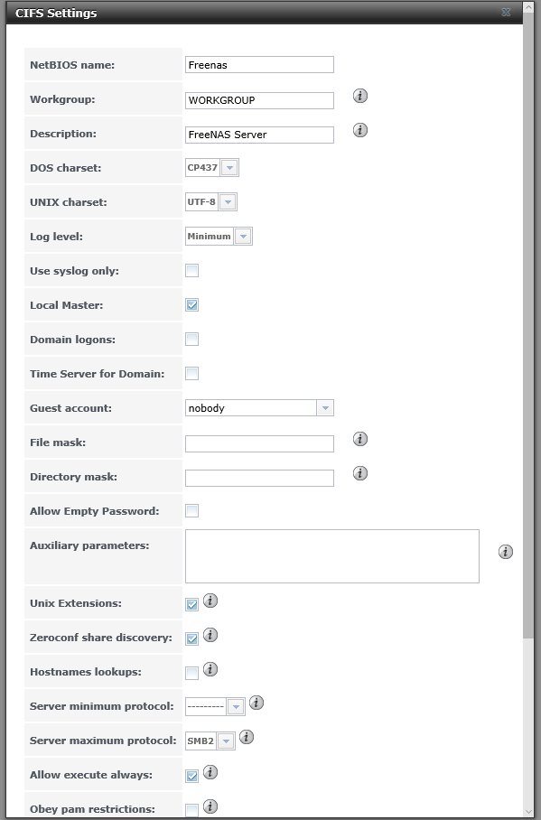

Screen shot of dataset settings and screen shot of share settings.

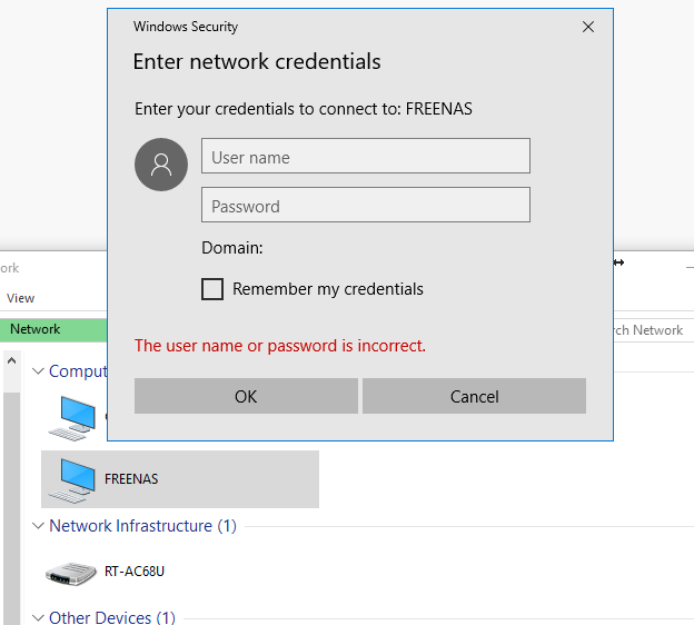

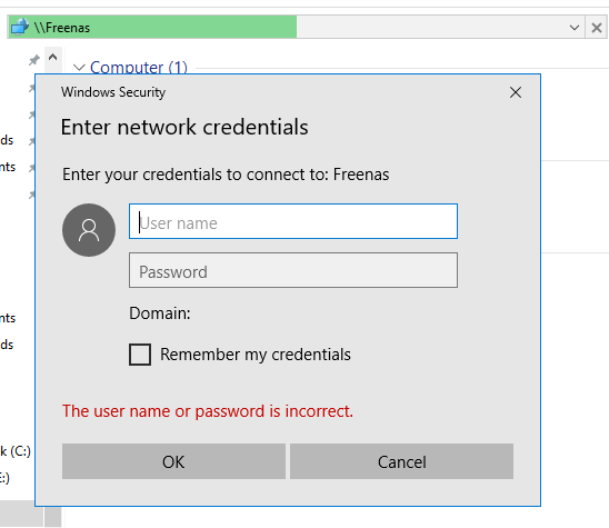

Here are the screenshots as requested, are there any logs that would help as well? I am attempting to connect to my shares using Windows 7, 10, and Kali (debian based I believe). All with mixed results. Kali cannot connect at all saying no route to host, windows 7 says cannot connect and it doesn't know why, but it sees the shares. Windows 10 has had the best luck with being able to connect under root credentials and had access to private which it should not have but after reboot it no longer did. Chris credentials aren't working for any of them, even media which has been 777'd. Sometimes it asks for a password when connecting to the cifs/smb server as a whole (not the shares individually). I am so confused :(

For your Chris user uncheck the Microsoft account box. Or are you actually trying to use your Microsoft account to log in? Usually that is an email address. Does Windows prompt you with a dialog box to login? And your saying it didn't work? Try rebooting everything.
As for Linux it sounds like your networking is messed up on that machine. Specifically you have a bad gateway or it's on a subnet that can't reach your freenas server.

The Linux machine is wirelessly connected and is DHCP'd, everything else works fine on it. I have tried unchecking the Microsoft account previously but I probably changed other things as well, I will try that and reboot and let you know the results.
As for the dialog box, yes windows prompts me for a login when I click FreeNAS on my network. But the behavior is supposed to ask me for credentials when logging into a share and not the server as a whole right? That is what used to happen pre-update anyways.

I wouldn't worry about if it asks you for credentials. Also don't use the freenas icon under network. Use an IP in a file browser window or map a network drive.

So I unchecked the Microsoft account and rebooted and I still don't have access to the private share, still asked for a password when initially connecting to the main folder which is not behavior I want as I want anyone to be able to access the media share in which I also cannot connect to but should be 100% public.

for the media share just set the 'only allow guest access' checkbox in the share settings. This will allow no password usage.

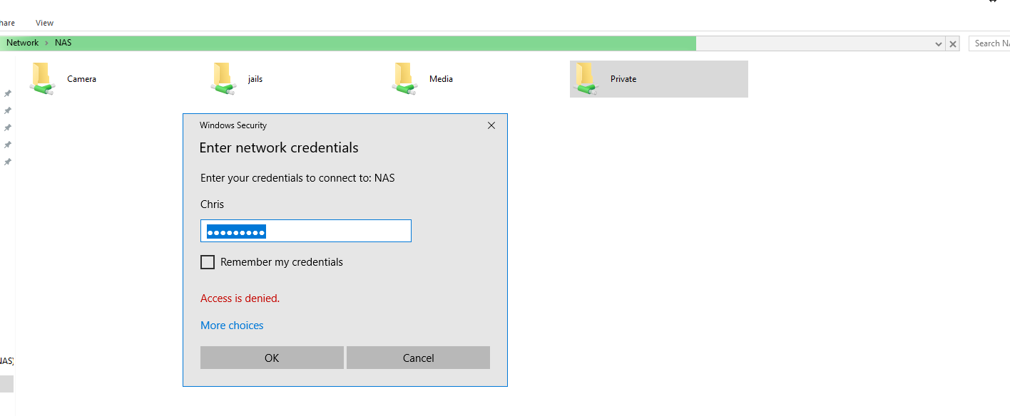

As for your private share I think you are goofing up something. Is the password you set for your FreeNAS user 'Chris' correct? Try resetting it to something simple for now so we can eliminate typo's. Any logs on FreeNAS, check /var/log/messages?

Yes it is definitely correct as I have changed it to be sure, it also allows me to connect to the root of the share and SSH. Even if I set it to only allow guest access for that share, it still requests a password to connect in general, a behavior it has never done to me before.

Dec 26, 2015
44
The picture shows the root, when I tried to get there it asked me for a password, then when I got there and tried to connect to media or private, both asked for a password and said access is denied.

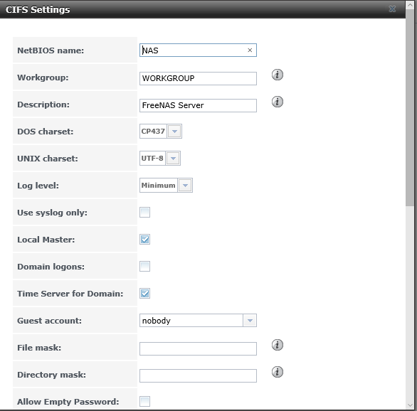

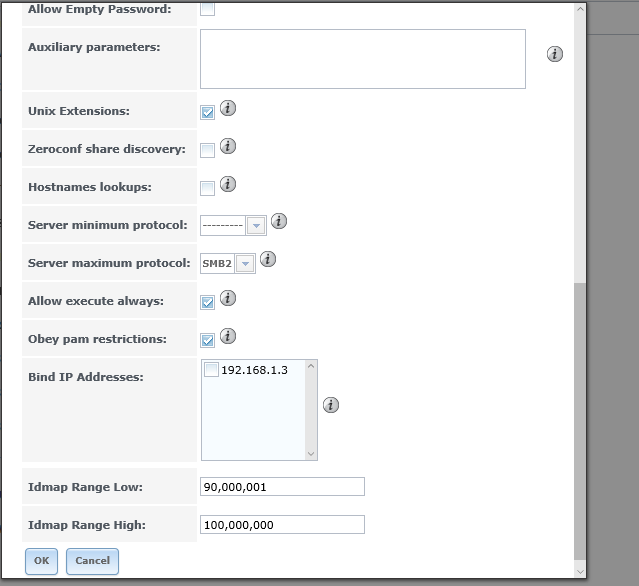

Here is the configuration file requested, how do I enable SFTP so I can get this in a bit more readable form as I manually added the returns on this?

I need to see the complete smb4.conf file. You can enable SFTP by enabling the SSH service on the server, (and perhaps adding the following settings under services -> ssh "Login as Root with password" "Allow Password Authentication") then use an SFTP client to authenticate and download the file. I do not recommend leaving "Login as Root with password" enabled.

No there should be a section for every share you have created.
