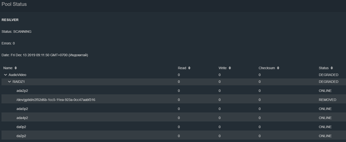

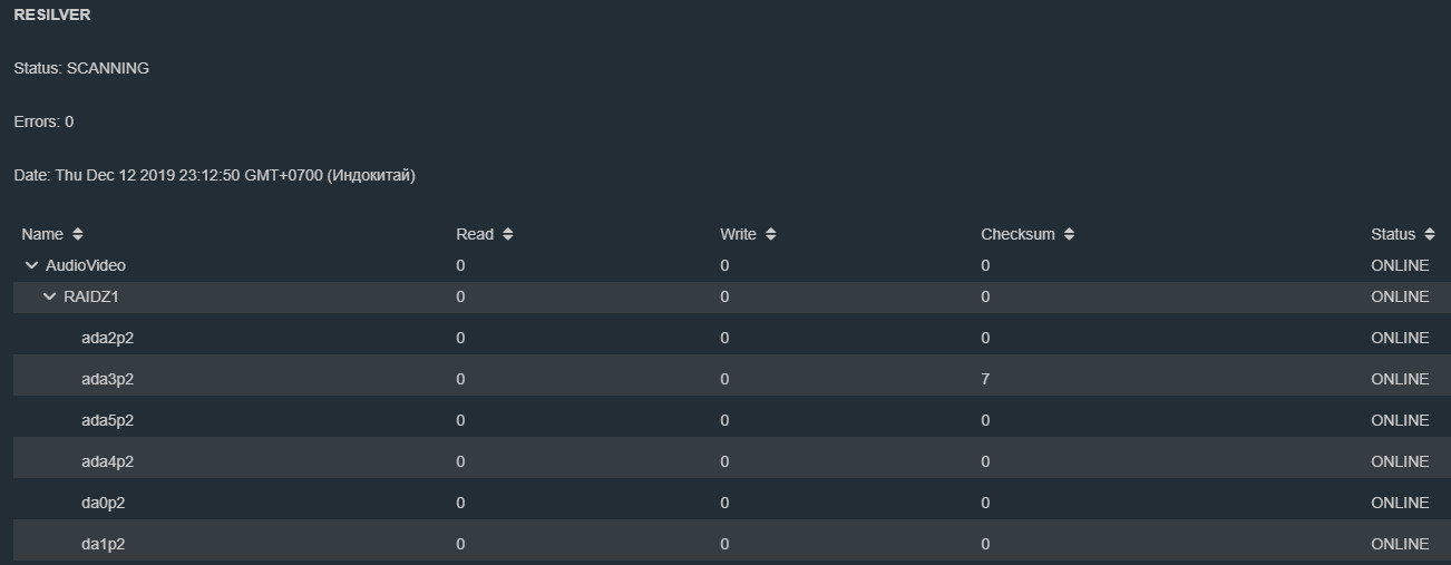

GolDenis
Oct 25, 2019
38
Replace !st disk (ada3)
Get that picture:
Question
When I should change the 2nd disk?
I'm confusing with "Status: SCANNING"
Should I wait to change the status/finish scanning?
GolDenis
Oct 25, 2019
38
aha . The problem became dipper, then I thought
After rebooting disk was returned into the pool....
But...After scanning completed - removed again
Checking status of zfs pools:
NAME           SIZE  ALLOC   FREE  CKPOINT  EXPANDSZ   FRAG    CAP  DEDUP  HEALTH  ALTROOT
AudioVideo    16.2T  6.98T  9.27T        -         -     2%    42%  1.00x  DEGRADED  /mnt
Backups       16.2T  6.73T  9.52T        -         -     1%    41%  1.00x  ONLINE  /mnt
freenas-boot   111G  1.64G   109G        -         -      -     1%  1.00x  ONLINE  -
  pool: AudioVideo
state: DEGRADED
status: One or more devices is currently being resilvered.  The pool will
    continue to function, possibly in a degraded state.
action: Wait for the resilver to complete.
  scan: resilver in progress since Thu Dec 12 23:12:50 2019
    5.46T scanned at 418M/s, 5.26T issued at 403M/s, 6.98T total
    43.0G resilvered, 75.37% done, 0 days 01:14:32 to go
config:
    AudioVideo                                      DEGRADED     4     0     0
      raidz1-0                                      DEGRADED     4     0     0
        gptid/bbb27d4e-0d64-11ea-9324-0cc47aabf316  ONLINE       4     0     0
        5749026980364468559                         REMOVED      0     0     0  was /dev/gptid/e2f52d6b-1cc5-11ea-923a-0cc47aabf316
        gptid/c1cfb2ad-0d64-11ea-9324-0cc47aabf316  ONLINE       0     0     0
        gptid/c48694cf-0d64-11ea-9324-0cc47aabf316  ONLINE       0     0     0
        gptid/c7c21b4c-0d64-11ea-9324-0cc47aabf316  ONLINE       0     0     0
        gptid/ccf0d828-0d64-11ea-9324-0cc47aabf316  ONLINE       0     0     0
errors: 3 data errors, use '-v' for a list
-- End of daily output --
reboot again...
Disk returned to the pool...
Scanning... disk removed out of the pool
That's a NEW disk.
How can I stop it and return the disk to the pool?
