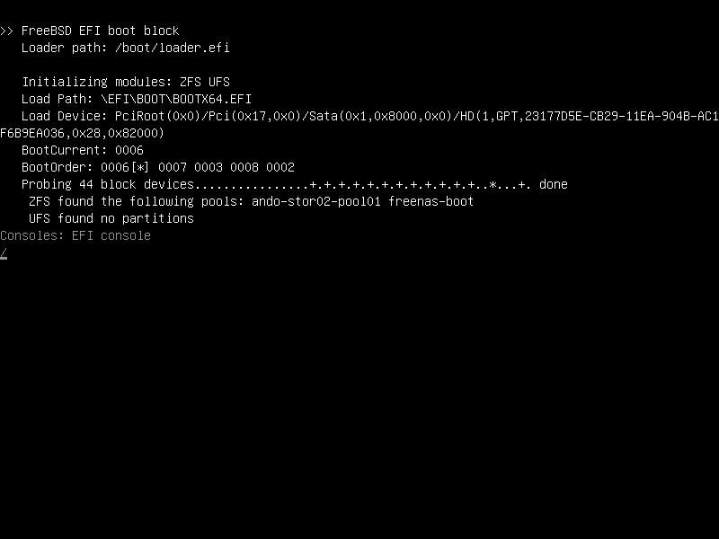

Was on 11.3U5 and changed train to 12.0 to update.
All seemed to be going OK and server rebooted (Supermicro)......but TrueNAS never came up and at the point in my screenshot (attached) it went no further :(
How do I recover this situation?
Thanks

Yes, it's failed. Reboot your machine and choose to manually start a previous boot environment, you should see your 11.3-U5 install there. Boot from that. Since you haven't upgraded your pool, you should just be right back to the pre-update state.
Apparently the UEFI loader in 12.0 isn't compatible with some machines that the 11.3 loader was. I had issues with this an older board. A BIOS/UEFI firmware update fixed it, but if you're already running the latest updates for your board, you may have to back up your config and switch to a BIOS-based boot rather than UEFI to make it work.
Thank you :smile: ......could you please point me in the direction of any guides to backing up config, changing BIOS type and reinstalling *without* losing any of my data?

The problem is that I don't see that screen at boot time, i.e. the FreeNAS boot screen.
I only see the one I attached in my original post....don't seem to be able to get anything else :frown:

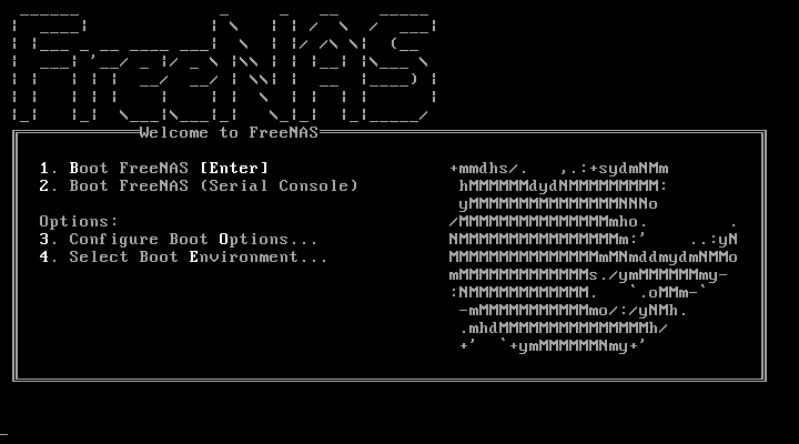

You should see something similar to this screen if you monitor the display output of your machine during the boot process (although with the new TrueNAS ASCII logo instead) - use "4. Select Boot Environment" and look for your pre-upgrade one.
I see, you are not even getting to the boot menu because UEFI is not finding the boot partition. I agree with @HoneyBadger , you probably need a BIOS / UEFI upgrade in your system board.
