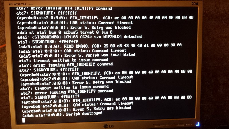

I have a HUGE problem here.
6x3tb drives in a zfs cluster, 18tb of data seems lost.
Added a few pictures showing screen on freenas server.
It's been running for 3 years, without progblems.
Is there ANY way of recovering from this without loosing EVERYTHING?
If I'm able to recover my pictures and documents, I'm a happy man, movies, music, games and programs are downloadable, documents and pictures are not.
If I pull the disk from the server, it boots, but ZFS does not mount.
Any way of mounting without the disk to try to recover stuff?
And yes, it is a stupid thing going stripe mode/raid0.

That's just it, the disk spins up fine, no smart errors or any other errors when in Ubuntu.
But, when freenas is trying to mount it the fun part begins.
Disk is Seagate.
I wish there was a way to mount the zfs and force-mount it without the "missing" drive, or mount it without any checks etc.
I'm also going to try another disk controller.
Might even put all disks in my other freenas server and try import there.
I have 15 years or so with pictures (about 14000) taken of family, friends and all......
The worst thing is the pictures :(

System does not boot with the drive attached, I have however not tried booting without the drive to disable automount and reboot.
