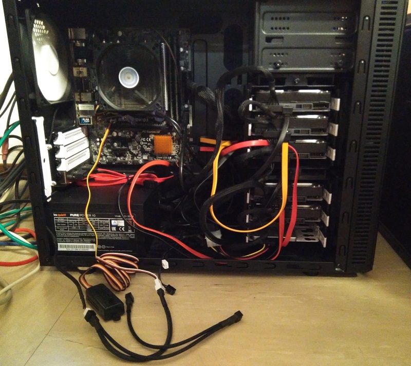

None of the above helped. There was only ONE thing left not yet replaced: a YF-VR882 3 fan power adapter cable (comes with a Fractal Design Define Mini mATX case) to three fans. The power adapter has some electronics.
Once the fan adapter was disconnected all SATA connections went back to normal, i.e. they were stable without ANY CAM errors.
I am now testing the fans with the mainboard fan connectors. Looks good so far.
Looks to me like an electronics parts on the adapter died during the course of the past months. It doesn't have a lot: two resistors, one diode, one transistor and a part with a turning knob marked as "VR" (my guess is Voltage Regulator).
Anyone else has experienced issues with a fan power adapters?

The issue is back. I've replaced the fan power supply with a cable from the mainboard using a Sharkoon regulator and a 1 to 3 adapter.
Maybe one of the fans is bad?

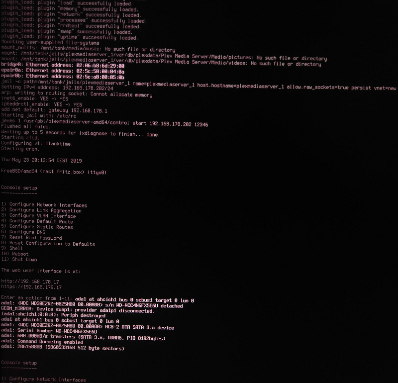

With three chassis fans, two in front, one in the back, I'm getting disk errors as per below. This setup worked from June 2018 to February 2019. Since February the situation gradually degraded.
I am now checking whether I can isolate one of the fans.
The errors I observed today happened some time this night between midnight and 10:00 in the morning. As access to the root partition was lost there is nothing in /var/log.
  • ada3.txt
  • ada4.txt
  • ada5.txt

Recently, there were some posts about a stand-off in the wrong position causing intermittent problems. Since the case itself was not changed, you should probably check that all stand-offs are accounted for and in the right places. This was one of @jgreco suggestions.
I personally once had issues with a bad molex to sata power connector that caused intermittent system problems. I went through a lot of things, including replacement of the power supply, before I found that one.
bal0an
Mar 2, 2012
72
Memory was not the issue. It was rather mundane, actually matching with the suspect list originally provided.
I replaced the Molex to SATA power connectors with brand new ones and it looks like that resolved the issue. System's running stable for 24 hours without any errors, under load and idling. I've made sure all of the used SATA power connectors went to the bin.
I guess the SATA power connectors had a dodgy cable, sometimes working fine and sometimes not.
I've never seen a cable become faulty in a server setup where the server case is not openend. In my case the disks sit in the case sideways, and the SATA power cables touch the case wall. With the hard disk vibrating and the cables pushing against the case my guess now is that the cables got stress fractures and dodgy contacts.
The original setup involved some ASMedia SATA controllers, and I one of those seems to have a bad link, too.
Having those issues in overlay and the SATA power connector sometimes working and sometimes not - got me epically confused.
